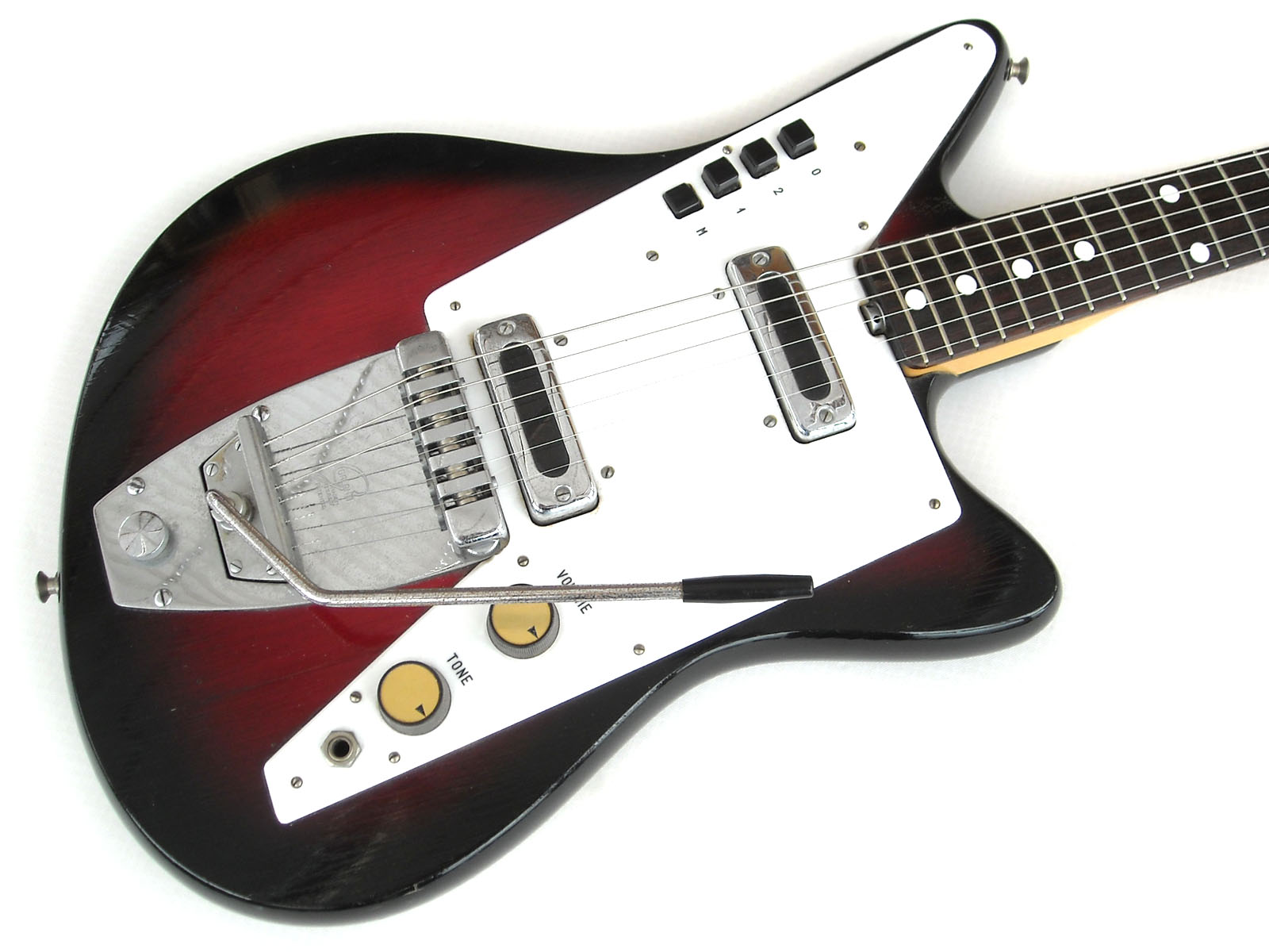

Hi all,
Just took delivery of a Galanti Grand Prix....
But it's got some issues with the sound. The bridge pup is very weedy and thin and the neck is loud with no treble content whatsoever. Off the bat, any ideas if this sounds like duff pickups or a wiring issue? I'm thinking it's the pups but strange that they would have what seems to be opposite faults.

I'm not an expert, but my vote is the pickups are the cause of it all. I've got a old Guyatone with similar problems. Not sure there's much that can be done short of getting them rewound. I think if you open it up, you'll be able to see if there're any wiring issues.
Re: Gorgeous 60s Galanti, bad pups?
Yeah it sounds like the pickups, unfortunately. That trem is sweet. Really the whole guitar is sweet. I wish guitar companies still did weird stuff like on that guitar

Thanks guys. You've echoed my thoughts. Guitar plays nice and that vibrato/bridge unit is a work of art - really well made, and works a treat.
I'll check the wiring but the guitar has obviously not seen much action so I can't imagine there's been any butchering in there.
I'll have to get it sorted whatever, it's way too sexy to not be being played.

Well I opened her up and I found a little circuit board with a highpass filter for the bridge pup and a lowpass for the neck - 1600pf cap and 100k resistor for each. Weird, that's nothing above 1khz on the neck and nothing below on the bridge (I think). I'll bypass it and expect to hear a vast improvement.

Horrible to work on! Short cables, weird bolts with spacers into a metal plate that houses the pickups....was really fiddly and took about 2 hours but I managed to bypass the filters with a piece of vero. Why do pickups have such feeble little wires coming off them?
Anyway it sounds much better. Why would they install such a thing? 2 choices - total mud or total tin.
