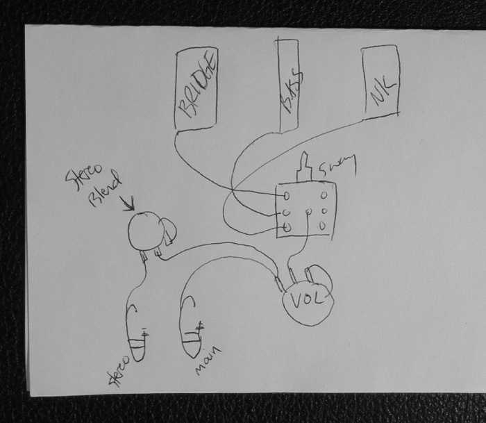

So I'm going to re-wire the stereo guitar I made. I want two humbuckers and the bass pickup in the middle.
Edit: would a stereo blend work something like this?
