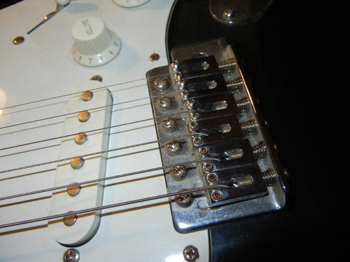

Also, the bridge is a little weird. Is it common to have strat-style tremolos that just screw into the body? Maybe I'm spoiled having a G&L as my actual strat-style axe...but it seems like you'd want something mounted in between the bridge and the body :idk:
So I'm going to fuck with that, too.

Classic six-screw Strat trems are screwed right in. Standard stuff. You could always get a cheapie Wilkinson and sink mounting posts in if you want a more modern setup. If you want a direct replacement six-screw, watch the string spacing and screw spacing. 10.5 mm spring spacing is entirely different from vintage Fender and not well served in the replacement parts market.

you want to leave a little play in the screws though with the end ones setting the height. the bridge should be able to pivot on the screws.
