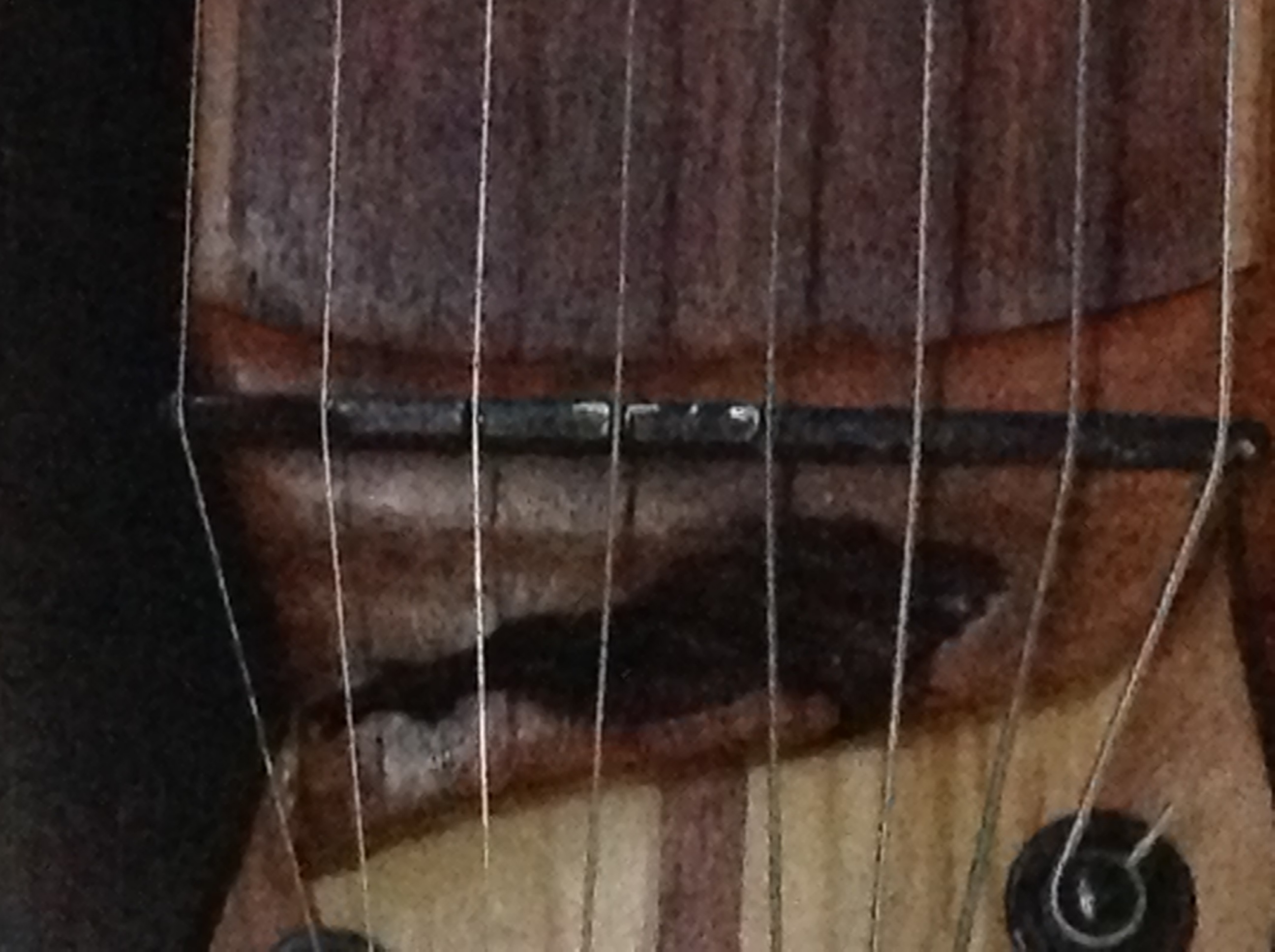

Hey if anyone is interested here's my latest.
Carved out neck and body, all recycled cedar (old fence), mahogany fretboard with homade dyed black claylike markers, cherry and aluminum bridge and nut, lace x bar, volume with push pull single/humbucker.

Ahhhh that's awesome, looks great.
I want a lap steel...

Re: Eight string lapper
¡Que interesante!
I gots to work on my picture skills. Maybe this one works better.
Thats gorgeous! How are you liking the alumitone? I have the deathbuckers in a couple of guitars and love em, also the P and J bass ones, are they just good across the whole line?
The alumitone is awesome. Super clear and defined for each string. This one is a little bright so I' m glad i put it at the neck, since I put no tone control. Very quiet as well even in non single mode, and this harness isn't even insulated. When clean I get a real acoustic like tone. My x bar also sounds great with fuzz.... Definitely my favourite pickup at the moment.
That looks sweet. I dig the rustic bridge
That's a neat looking piece there, very nice.
Wow man that looks so awesome!! Good job!
