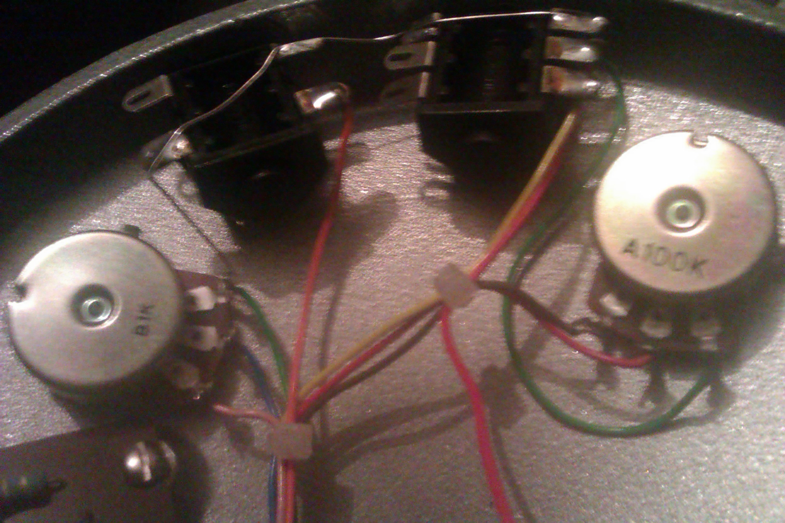

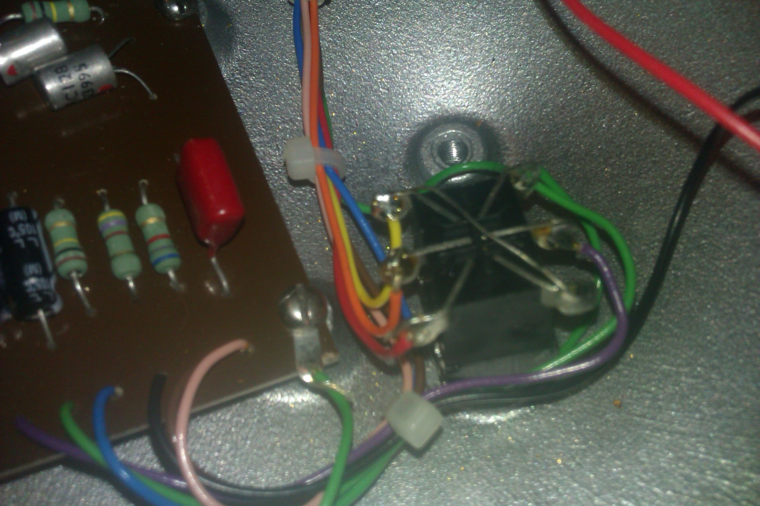

£40, better than i expected. i took some pictures of its guts for you, ill post them just now
£40, better than i expected. i took some pictures of its guts for you, ill post them just nowsonidero wrote:EMOTIONAL ATTACHMENTS TO SMALL METAL BOXES!!!

2

3

4

Nothing I'm spotting by way of an obvious broken connection. You might keep an eye out for the potential of components and connections to short out against the case. I had a pedal go intermittent because the prior owner had removed the original insulation between pcb and base-plate.
