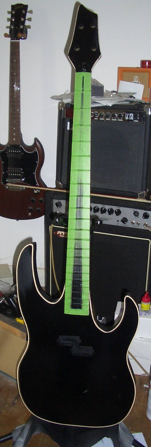

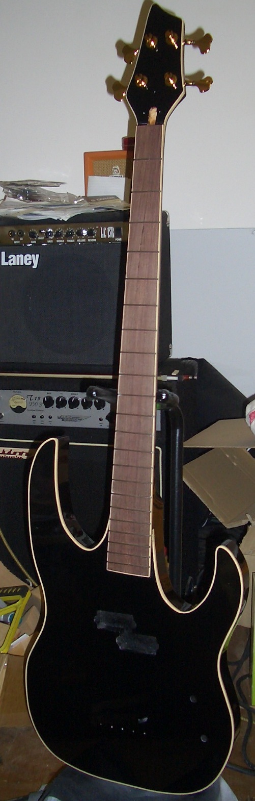

Last weekend I finished the clear coat and let it dry for a 4 days. This was followed by a couple of days of wet sanding the whole bass with 2000 grit sandpaper. Today I decided the surface was even enough (and I was in danger of sanding through the clear coat) and went on to apply the polish. This meant I could finally start bolting on the hardware I've had for almost a year!
(You can just about see the reflection of the tuning pegs here)
The fretboard also no longer needs any protection, so this is what the bass looks like right now (click for bigger):
Only a few more things to do! Apart from the soldering and mounting of hardware I still need to slot the nut.

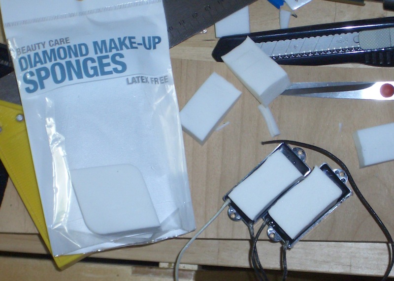

Since the pickup didn't come with any foam to mount it on, I had been looking for a material to use. As it turns out, make-up sponges are soft & springy, and with the help of my girlfriend I got hold of some large enough to be cut down to size.

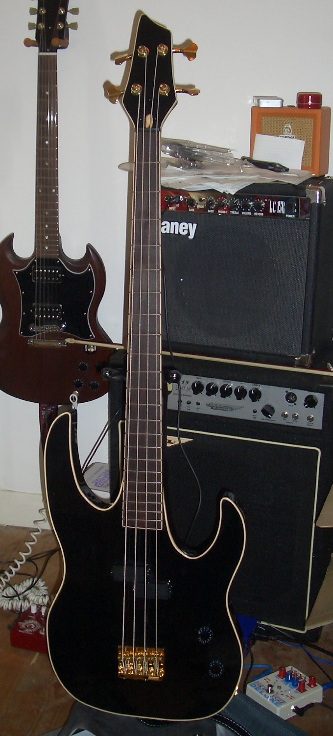

And since the last missing part, the nut, arrived today the bass is now done! (click for larger size)
After 53 weeks since placing the order for the neck blank I'm so happy I finally have an instrument! It still needs some setup work (the intonation is pants and there is quite some fret buzz in places) but it is entirely playable!
