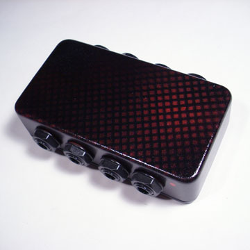

glitch
Posts: 89
Joined: Fri Dec 08, 2006 1:22 am
Location: Hong Kong
Re: 4 way multiple?
Post by glitch »
Bleak Mult from The Squarewave Parade.
From http://www.thesquarewaveparade.com/bleak-mult.html:
"this is a simple dual passive multiple. its generally used in modular synths and used in the same way a ‘Y’ cable would, but with more options. first off there are 2 four channel mults. one on each side. but above the right most jack of one side you will see a red or blue dot, if you do not plug anything into this jack then it will work as a seven point mult. once you do insert a cable into the marked jack it breaks the two sides apart and give you a dual four channel mult. each jack has a sum total of 1k impedance just to play it safe when using odd gear that might not have taken multing into consideration, so that nothing is damaged, and of course it can process audio or CV. oh and there are three with blue stencils and four with red. cases are powder coated black."
Uhhhm, maybe perhaps...?
