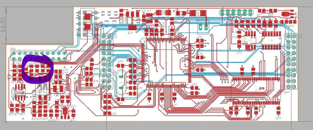

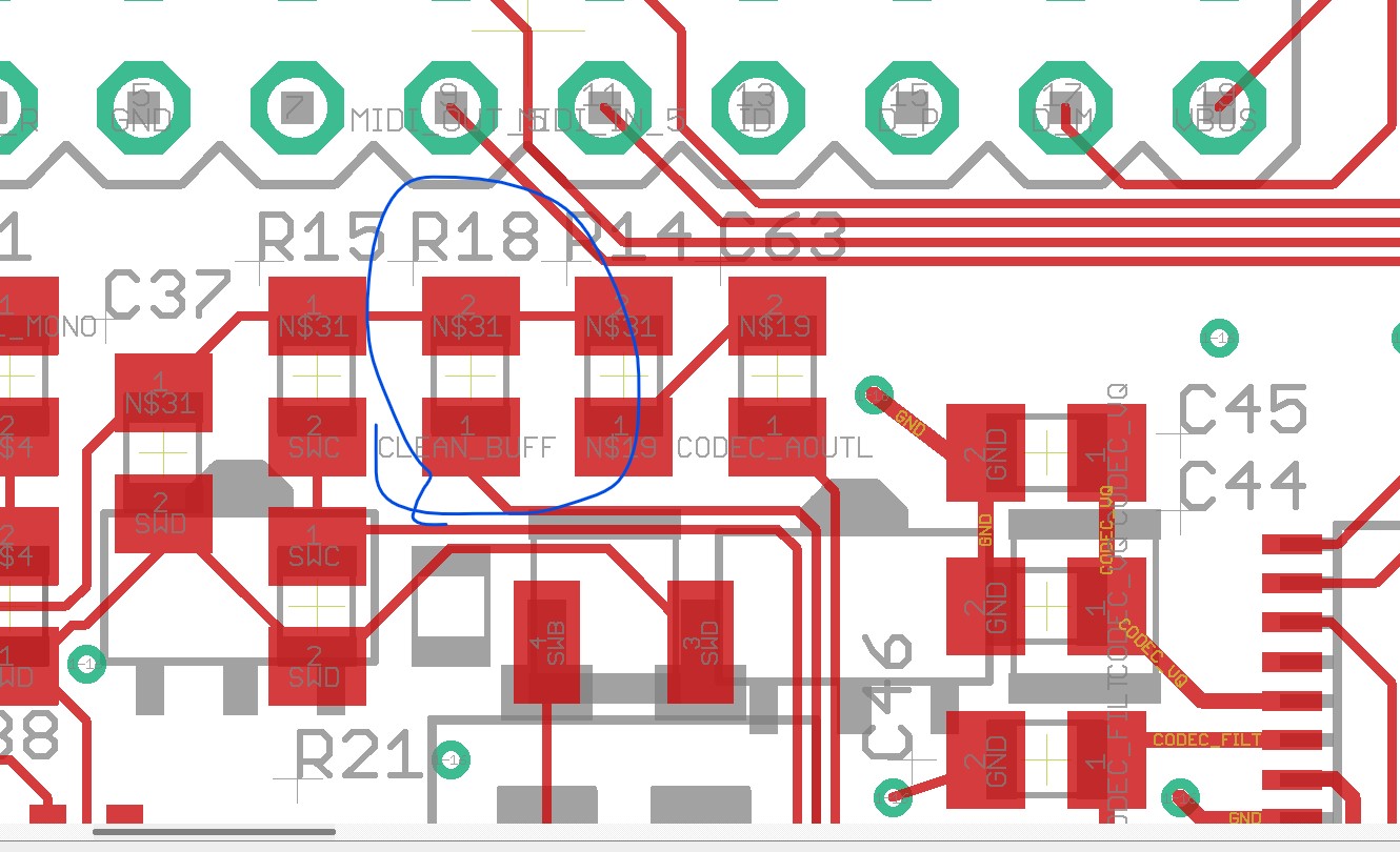

i can just show it here, but do you have the new version or old version?
(old)
(new)
Screenshot 2021-10-06 174952.jpg (37.51 KiB) Viewed 11455 times

I have the new version
multi_s
Posts: 2098
Joined: Mon Feb 15, 2010 9:00 pm
Re: Kill dry for 856 for Zellersasn
Post by multi_s »
you need to remove the back plate.
you will see there are 3 circuit boards, 2 of them are stacked together.
you need to remove the smaller of the stacked boards in order to access the opposite side of it.
once you can flip it over you can remove R18. This will disconnect the dry signal from the output mixer which sums the wet from the dsp with a buffered dry signal.

Just to follow up I did this today and it worked like a charm. Dry signal is totally silent.
One unforeseen bonus is it feels like the limiter, not having the deal with the dry signal, is less aggressive. Anyhow, for anyone who likes to run their loopers in parallel with their dry instrument signal, this mod is the trick.
There’s probably no going back though. That resistor is small and I definitely don’t have the skills to reverse this.
