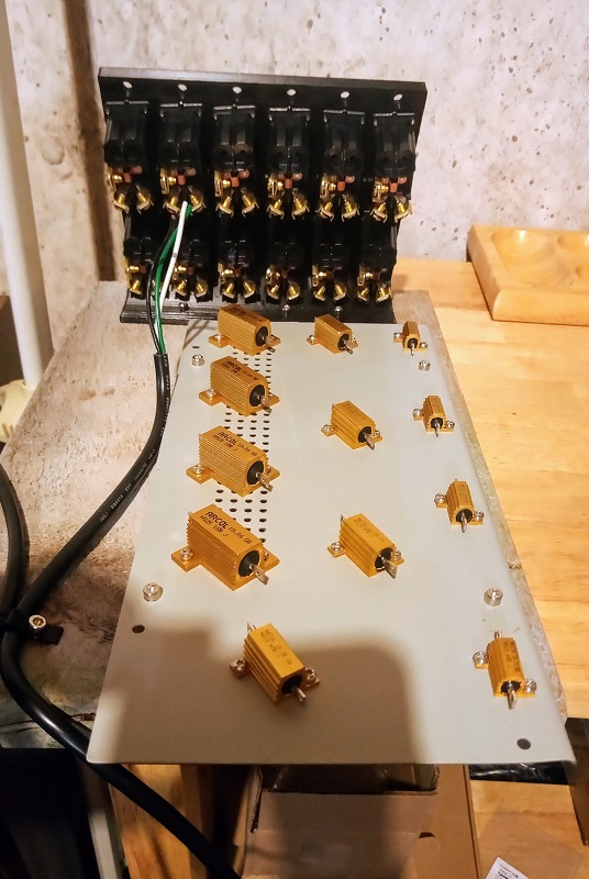

matte black PCB panels. I made a matrix mixer, a joystick, a 2HP multiple. I have in the works a dual analog comparator module with extra features. designing a power supply module and a powered bus board was a huge deal because I had to make a lot of special equipment for loading and probing power supplies under controlled conditions. this is not even all of the stuff I have for power supplies. I have more PCB for power testing stuff.
