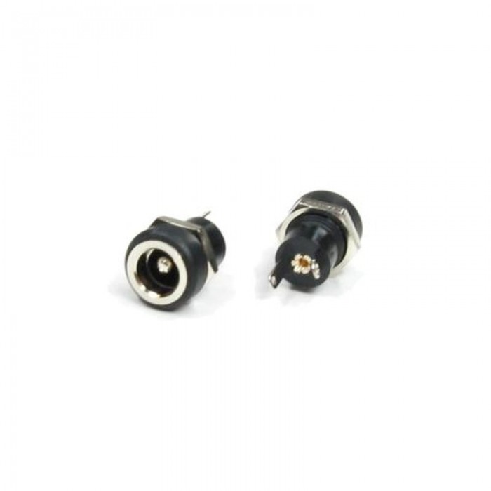

You could probably just drill a small hole somewhere else on the pedal and add one of these:
https://smallbear-electronics.mybigcomm ... ed-2-1-mm/
It's a really simple part so it should be really simple to wire it up for a standard center-negative plug. Just make sure the ground is connected to the right pin (the shorter one).

Yea, looks like what was used for the modded one I saw a photo from owned by The Artist Formerly Known as...I kid, I kid, Mr. Spiral Effects.
With a washer, fits in the existing hole.
Just wasn't sure what the part *was* as much as anything.

Re: Modding vintage DOD Performer 18v 1/4" to ..not 1/4"
Yea that first jack should work fine, and you wouldn't have to expand the existing hole. Definitely use a washer like you said, as the jack will stay, but if over tightened or pushed hard it'll likely pop into the enclosure. The lip is just big enough.
Of course the second works as well! Just a matter of if you want to "permanently" change the pedal. The first smaller jack doesn't have the battery switched terminal either, but I don't think you'll be using that anyway.
Let me know if you need one of either of those jacks types and I'll send em over. I have plenty and that way you don't have to place an order somewhere for just that.
