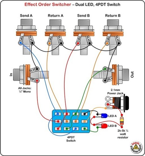

I don't get the little grey wires on the fx switches.....why are they there?

Upper switches look like bypass (I nest the order switcher AFTER bypass when I employ it).

But why the little greys running horizontal on the bypass switches? They seem redundant to me and I want to use a bi-colour LED.
Do you have a layout image Curt for what you use?

Oh shit, I hadn't noticed those.
I agree, they appear to serve no function. Here's a pic of some build notes that employ the order switcher:
"RED" & "BLUE" refer to the LED color, the LED being a two leg bi-color (note the feed from 50% Vcc, actual point is different because the blue is brighter than the red when fed the same, but anyway...

This what I've used but pedals instead of send and return. And then standard 3pdt switching for each effect.

Looks like I'm better off with two LEDs than a bicolour. Damn, I already drilled a hole dead centre.

You can buy three legged bi-color and electrically treat it in the manner above.

I'm using a 3pdt toggle for my order flipper though. I think I've worked out a way to do it using the 3pdt fx switches.
EDIT: No I haven't....I need 3 states - one for A, one for B and one for A+B....so a tri-colour LED, which I have but I don't think there's a way to do it with this unless 2 colours in the LED mix to produce a 3rd?

The horizontal lines are a bit strange but the only thing wrong with it is that it wastes wire. If you already wired it up then there is no good reason to change it. I think it was copied and changed from another image floating around by someone who removed something but forgot to remove the jumper.
