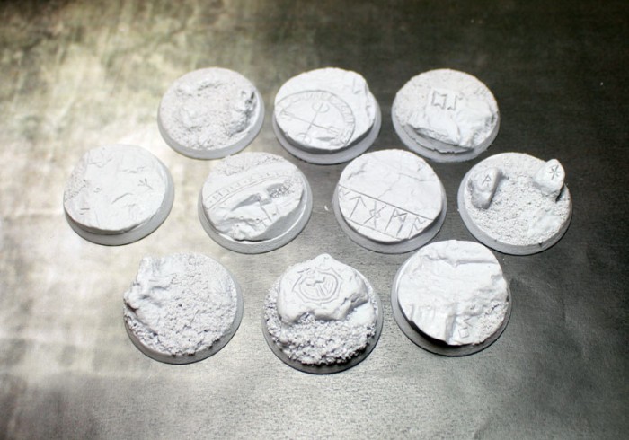

The bases I use for this army are these:
They're solid resin, so I'll need to carve out room for the battery, etc. I would prefer to use 25mm or 32mm-diameter bases, but could be talked into 40mm. Any bigger than that, and it might be too obstructive.
