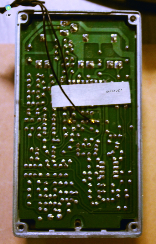

frodog
Posts: 1530
Re: any circuit benders up in harrrr?
Post by frodog »
Whoo, I like that patchbay! Was there another thread like this? Anyway, posting here because I finished my second sketchy-ass (but working for now) bend, on an Ibanez Distortion Charger. So I'm a noob, but it is fun to modify shit. Plan to do that/build more.
As I've done before with my Casio Rapman keyboard, all I did was solder a 3v blue LED between two points. This time I didn't have a switch for it, so it's just hardwired. However, it was a struggle soldering the wires to the points, and I suspect this is because I didn't clean the metal before soldering. Like I said, rookie, but especially with an old circuit board like this I suppose that's a concern? After some cussing and burnt fingers I managed to get the joints reasonably secure, taped them up, and ran the wires around the edge of the board to the LED inside the pedal. Didn't bother to drill a hole for it, but might be cool later if/when I open it up again and do it properly. THE SOUND.. brutally gated squarewave LED clipping? I like it better than before at least. Still lacks bass (would different input caps solve this?) but the EQ works and it's still stereo (I use it first-in-chain, split for parallel fx). No sound clips, sorry, but you can probably imagine the ballpark.
To be honest irt the marked point to the right there, I'm not 100% sure if it ended up being soldered there or the point to the right of it. Initially I thought I had to bridge them, you can kinda see they're connected on the blurry pic, but only one is needed. As for +/-, don't remember.
