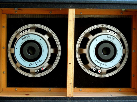

- goroth
- Posts: 13514
Re: Need speaker suggestions...
EVM12L does everything awesomely.
Re: 1 watt amps. You'll want a fairly efficient speaker. Around 100dB will give you plenty of punch.

- cheesecats
- Posts: 695
- Joined: Tue Oct 27, 2009 2:59 pm
- Location: Virginia
this is my recommendation as well. pricey, but worth it.goroth wrote:EVM12L does everything awesomely.
