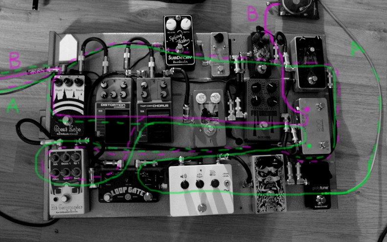

frodog
Posts: 1530
Re: Pedalboard for both guitar and synth
Post by frodog »
Yo, here's the routing drawing, Willem. My board has changed a little since, but it's the same signal routing. The green line is the guitar, as you can see it kind of goes back around (long cable) after the Bit Cmndr and goes through the top row of pedals and out to amp A. The pink line is the synth/anything connected to the mixer, and is split at the Ibanez TC10 chorus so one output goes back into the loop and the other goes to the DS10 distortion>Ghost Echo>amp B. Oh and both outputs go into a JamMan Solo XT looper before the amps, so I can loop in true stereo.
So if you used a setup similar to this, you would only need an ABY switcher, using the loop on the LS-2 and the iStomp at the end of that loop. That is, if the iStomp can split a mono signal to stereo even when off. Or, you could, like you said, just have an ABY at the end of the chain before the 720 and the LS-2 at the beginning as an input selector. That would probably be the easiest solution. The only advantages to a setup like mine is that you can adjust the level of each channel independently (with the DS10 for ch. B and the Accountant compressor for ch. A) and you also don't get volume loss if you have a passive splitter at the end of yr chain.
Damn, I feel like I'm just complicating things... I'm sure you'll find a way to do it, though. You have a very cool collection of pedals, good luck!
Willem
Posts: 425
Joined: Sat Mar 08, 2014 4:28 pm
Location: France
Post by Willem »
Thanks for taking time to let it more explicite with a picture. LS-2 let me mix the output, that's a nice feature.
I actually already used the iStomp as splitter in order to isolate my tuner which is always on if I use my CT5 in order to fine tune my loops with mode 2 and 3.
