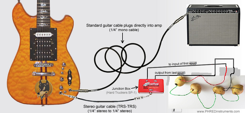

you may want to try this setup for better response from the volume knob

I've been kind of fixated on this concept for a while, despite having found very few applications that sound good or interesting. Filter stuff always works, of course, but so many other effects are either vanishingly subtle (modulation speed, say) or obnoxiously unsubtle (pitch, usually). I was sure having envelope control over Generation Loss parameters with the Arcades pedal would be totally sweet, but it has not proven to be so. Maybe a little sweet. My favorite application is having the envelope change the delay time on the Time Bender just a tiny bit. If you hold a loop and then play over it, the longer you play the more degraded the loop gets. I apologize for having no potato jokes.
