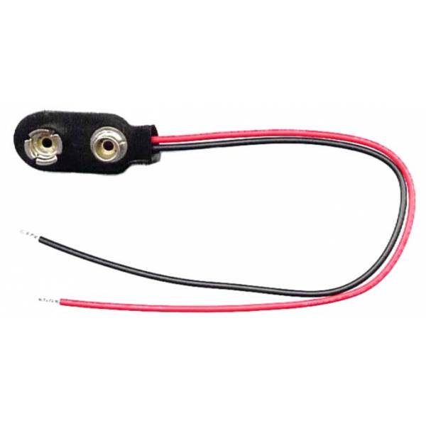

I have a few battery only pedals that I regularly forget to unplug ... :facepalm:
So, I would like to power them with my regular, isolated power supply without actually modding the pedal itself.
There are cables for that, I've seen Voodoo Labs has them https://shop.musix.ch/en/VoodooLab-9V-B ... 06995.html
But I thought I could just take a battery snap connector like this
and then solder it to one of those dc jacks
Would that work and which wire of the snap goes where on the dc jack?
I'm not sure, as I'd flip the polarity (plus/minus) by attaching my clip to the clip of the pedal, right?
Which means that .... :idk:
Thanks.

The cable you linked is actually for running a pedal with a dc jack, off a battery, not the other way around (notice the male type plug).
You are correct though, you would need to flip the polarity, since going battery snap to snap.
Hook up the black wire from your new battery snap to the "9v pcb pad" and the red wire to the "GND" on the dc jack. This will give the proper polarity once plugged into your pedals battery connection...If you hook the black wire to the "wire of battery connector" it won't work, as this is switched off when a barrel is plugged in to the dc jack.

Jero wrote:The cable you linked is actually for running a pedal with a dc jack, off a battery, not the other way around (notice the male type plug).
Ha-ha, great! I didn't pay attention. The description had me with mentioning "vintage pedals without power jacks" ...
:excellent: Thanks a lot for clearing that up.

No problem. And good catch on the polarity thing btw, as that's an easy oversight if you're not used to messing with this stuff. It seems weird to connect the snap backwards, but it is correct in this instance, haha. I knew it was right, and I still actually hooked this up and tested it with a meter.

Jero wrote:No problem. And good catch on the polarity thing btw, as that's an easy oversight if you're not used to messing with this stuff. It seems weird to connect the snap backwards, but it is correct in this instance, haha. I knew it was right, and I still actually hooked this up and tested it with a meter.

Thanks, but I have a few of those those snaps and sockets I posted already lying around, so I'll just use them.
