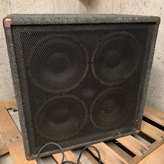

Want a cheap 410? I’ve got a Carvin that I’m not using and originally got for cheap - and I’m going to be in MTL once or twice this month.
It’s heavy for it’s size, needs one of its handles replaced, and is generally unattractive. Provided I can unfuck my back and get it up the stairs, throw me $50? for gas and it’s yours.

Damn doomeow thanks for the offer ! But the thing is, I'm already kinda worrying about the space available for the SWR (if I do get it... the guy should come by on Friday) so I don't think a 4x10 would be a good choice here. My amp is kinda jammed in between the mixer and a drumkit, and it's already kind of a tight space to get to the drum..

You should accept the excellent offer on the Carvin cab, and make room in the practice space. The Carvin 4x10 will be louder than a Sunn 1x15. Bring the Sunn cab home, if there's no room. Maybe sell it and try to get a bigger amp head.
