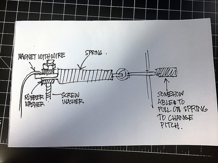

-Pardon the quick sketch but I was also thinking of using a rubber washer, spring, then agent with another washer on top to vibrate the spring. Could I wrap some shielded wire around the magnets and attached them to a battery supply? would that increase the strength?

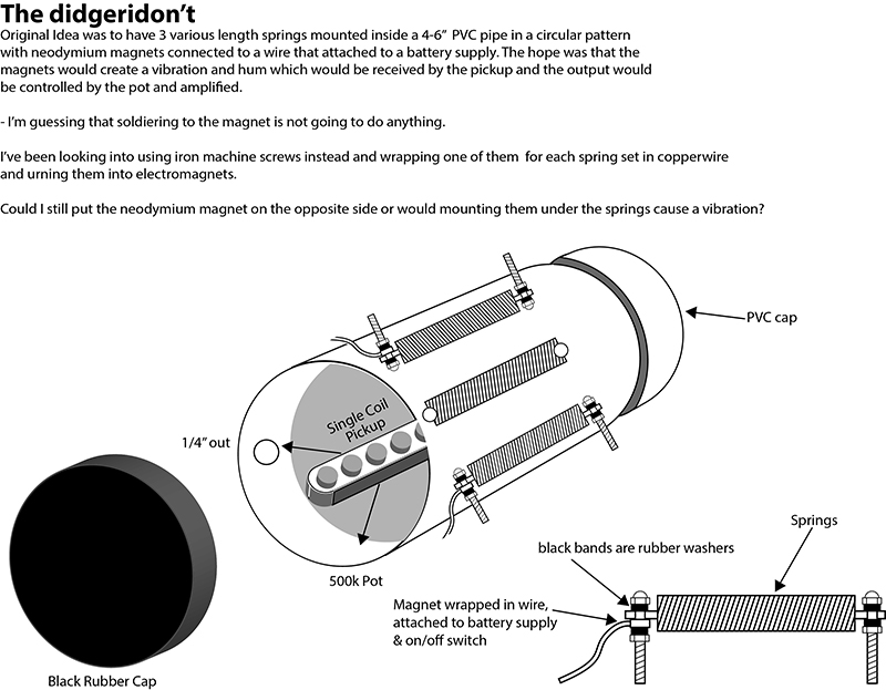

Here's a brief write up along with a better illustration of what I had in mind:
The didgeridon’t
Original Idea was to have 3 various length springs mounted inside a 4-6” PVC pipe in a circular pattern
with neodymium magnets connected to a wire that attached to a battery supply. The hope was that the
magnets would create a vibration and hum which would be received by the pickup and the output would
be controlled by the pot and amplified.
- I’m guessing that soldiering to the magnet is not going to do anything.
I’ve been looking into using iron machine screws instead and wrapping one of them for each spring set in copperwire
and urning them into electromagnets.
Could I still put the neodymium magnet on the opposite side or would mounting them under the springs cause a vibration?
- crochambeau
- Posts: 2220
- Location: Cascadia
Re: An odd idea that hopefully doesn't end up with me in the
I believe a permanent (neodymium) magnet is just going to exert a constant push or pull to a magnetic material.
It will be a static system.
If your goal is to create vibration, you will need something to excite the spring. Physically reaching over and jostling it will work, until equilibrium (rest) is reached, for drone you'll want something active. Like an alternating magnetic field (the mechanics behind a speaker) or a periodic on/off switching of your battery.
I'd say: by all means, build the thing, and then modify it to function if it does not meet your needs. It's the best way to learn this shit. Take a breath and dive in. Have fun!

Thanks! I had stopped by a radioshack that was going out of business and bought a bunch of shit for $2 a piece and picked up 4 piezo buzzers. No idea if they would be useful. Makes on hell of a god awful noise though.crochambeau wrote:I believe a permanent (neodymium) magnet is just going to exert a constant push or pull to a magnetic material.

I had a basic idea for a controllable spring exciter.. You could use a small electric motor with an off-center (unbalanced) item on the end, so when you spin it, it will vibrate, and it will vibrate more and more as the motor spins faster. Kind of like the old rock polishers, minus the smoothing media in a can! :P A rotary vibrator? mmm.. anyway. Simple solid state motor speed control via a potentiometer controlling voltage.. boom.

So would i need a motor for each spring? I was planning on mounting 3 of them plus the pickup and 1/4" jack, or 1 motor that brushed each spring?
My other thought was to get copper wire and wrap it around the inside of the PVC pipe walls in the area of the springs and soldiering a power supply to it to create a magnetic field that would vibrate the springs in the tube, though I'm not sure if that will work. I've been doing a lot of reading on this and started reading the Make: electronics book as well.

If the springs had a "Floating" mount, as in whatever they are mounted to is rigid between them, but the mounting apparatus itself is attached to a secondary board with rubber feet or something similar, then you just mount the motor to the same apparatus as the springs (or each spring mounted separately with its own motor, controlled independently) and let it go vibratory on you, or you could also mount the motor to the spring "pillar" that holds one end of the spring, sending the vibrations down the spring directly in an axial manner I would suspect. It would be easy to mock up with some cheap plywood and some 8-32 or similar machine hardware.
