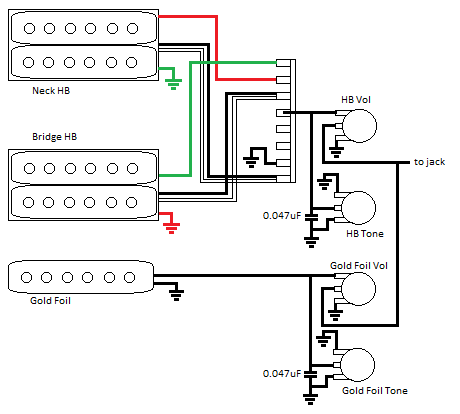

Alright, I've finally had some time to sit down and figure out the wiring. I think this is what I'm going to go with (based off this https://docs.google.com/gview?embedded= ... _1V_1T.pdf):
Wiring Diagram.png (11.16 KiB) Viewed 15090 times
Which I believe should give me:
Position 1: Bridge HB
Position 2: Bridge + Neck HB
Position 3: Neck HB
Position 4: Bridge + Neck tapped
Position 5: Bridge tapped
Plus I'd be able to blend the gold foil into any of those settings or would be able to get the gold foil alone by turning the HB volume down.
Does that make sense? I just want to make sure I have everything straight before I start soldering.

Re: Sterling/Musicman project
Posted: Sat Feb 18, 2017 7:43 pm
by DRodriguez
That is hot as hell. :snax:
