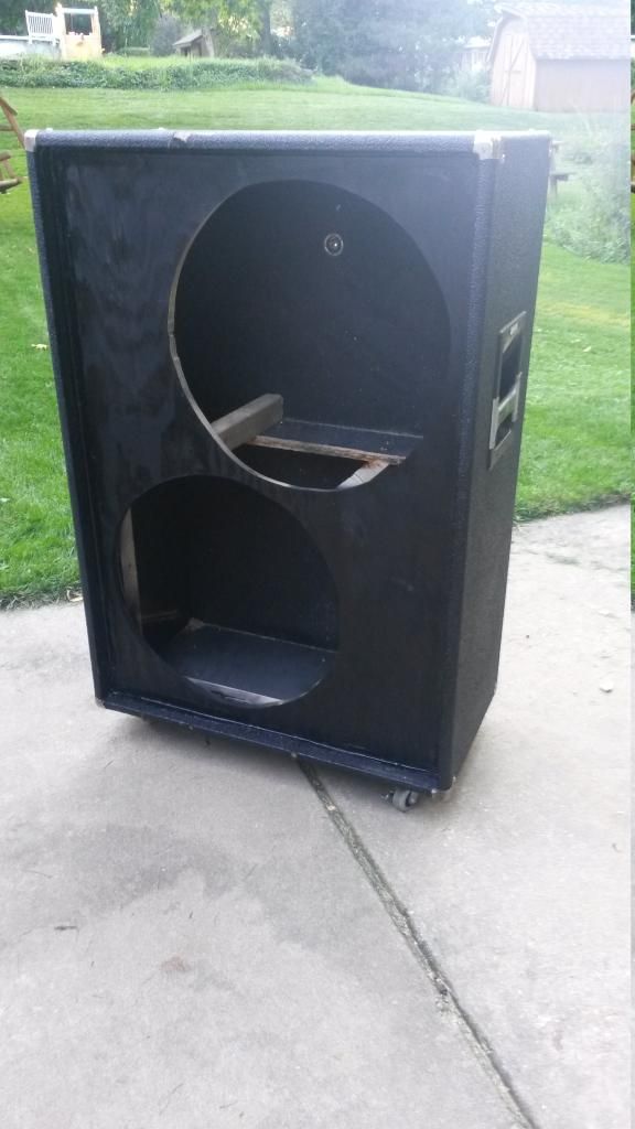

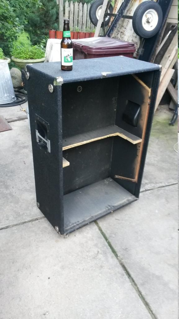

Blam! Progress.
Took some figuring out how to best dismantle it. A sawzall and a hammer worked best. Like I said she's not gonna be pretty. Left part of the middle partition figuring it would help bracing even a little bit.
I need about 15 feet of 1x1 and a sheet of whatever I'm making the baffle from. What should I make it from?

3/4 pine ply
