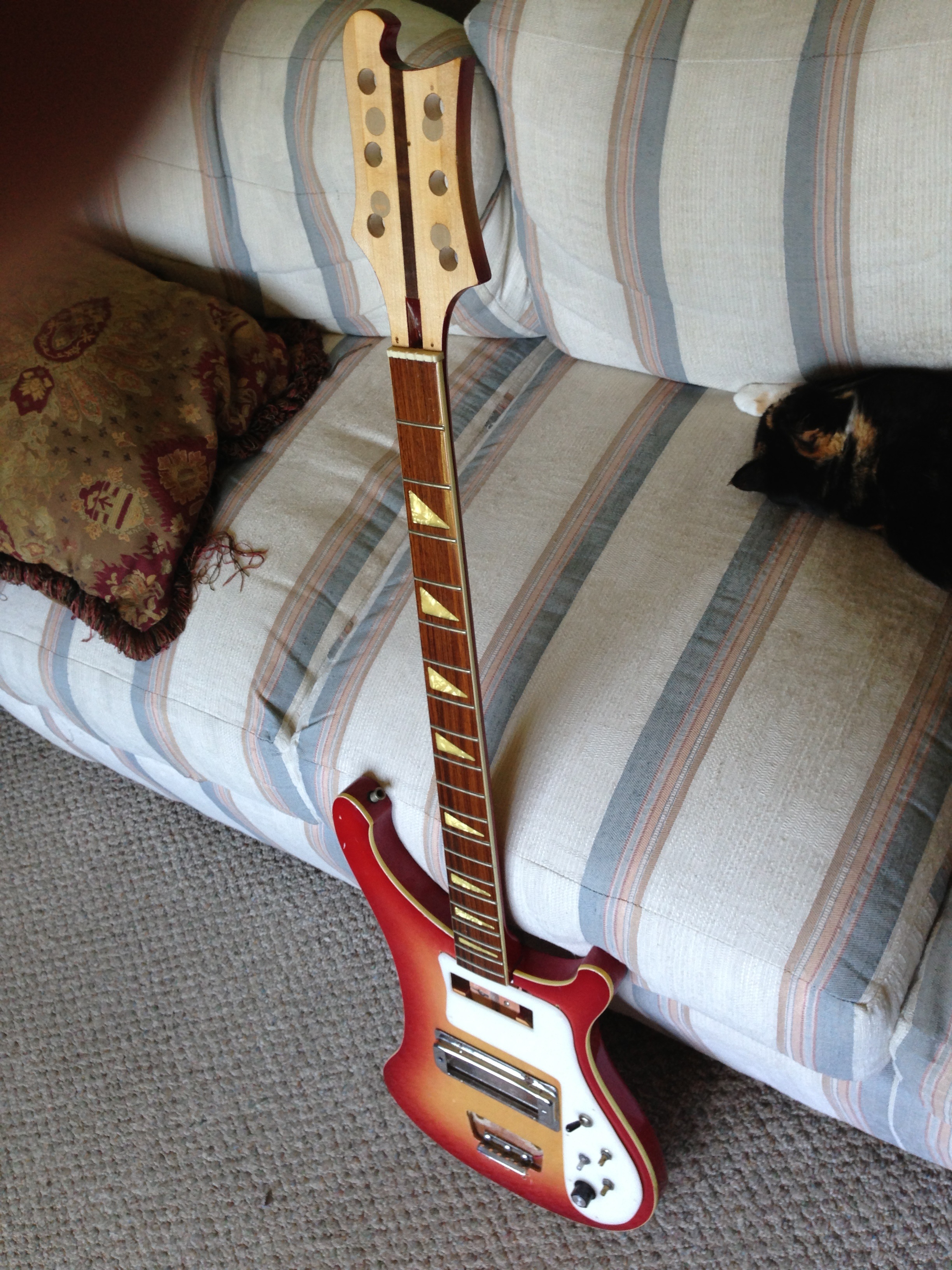

OK, dudes. Just came into possession of an old (Hondo?) Rickenbacker bass copy that I'm going to try and refinish. It was partially modded as a six-string but apparently never completed. Holes for tuning machines have been filled + redrilled, A six-string nut + tailpiece are attached. My idea is to refinish it myself, procure the missing parts, and then have a local dude I trust actually assemble the thing. But I'm playing more baritone than bass now, was curious about the possibility of setting it up as a baritone (B-B). Can a 33.5" scale bass work as a(n even-remotely-usable) baritone? :erm: I mean, I'll proceed with the refinishing project either way, just hoping this might be a cheap(er) way to quiet my "new baritone??" urges (for a while)...

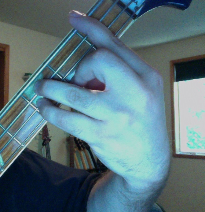

Nelson Instruments wrote:My two cents is that even if you can find baritone strings long enough, a 33.5" scale baritone would be a bitch to play chords on.
How come?
Posts: 14996
Re: Baritone scale question
too much space between the frets. a first-position chord would require hands the size of your head.
Posts: 16707
nah...
