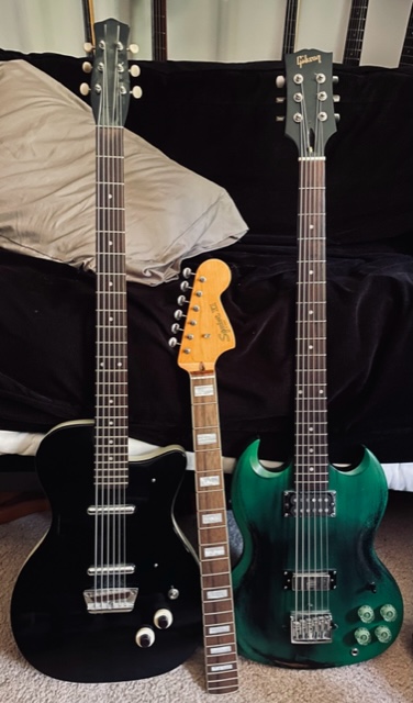

I got a neck from one of 'dem squires.. [and a firebird body coming]
here it is with my other 2 bass VIs [90's dano I got new in 99] and my SG bass to EB6 conversion

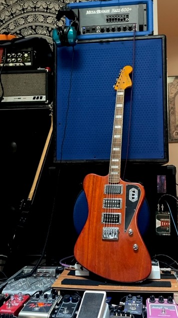

New Bass Vi
Squire neck
Rosser guitars body
Rio Grande Pickups: Crunchbox, Muy Grande Bucker, Punchbox
This the first Bassvi Ive had that i actually like the way it plays, vs put up with
running Ernie Ball cobalt flats for the lows and rounds for the 2 high strings

Interesting idea mixing rounds and flats! I never managed to get my Squier to a point where it really played well. Flats were best for the lows but then the highs felt wrong for "guitar-like" playing. Maybe that's the genius solution! :!!!:

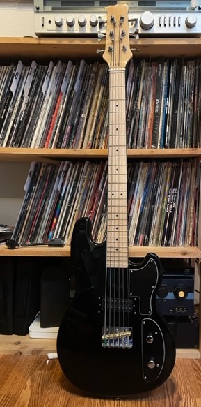

Here is the updated picture of my Eastwood Hooky 6 Pro
New black pick guard
Seymour Duncan Invader pickup [the FUCKER that I got it from drilled out the height adjustment holes so I had to.. use p90 wood screws to get it to work...]
Made a new control plate with a bit more pleasing shape without messing the Shergold ascetic
New wiring/pots/cap/
new knobs
Flats

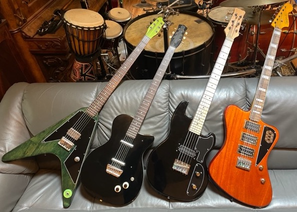

Here is also a shot with all my other working bass 6s

Wow, i love these. The V and the Firebird are wild!

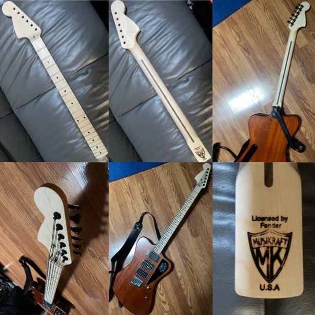

Update #2
I got a new neck for the fenderbird from musikraft
The squire neck was too temperamental with weather and too small for me for how I play
Specs: one piece construction, dual action truss rod, 1.75” nut width, 60s pbass neck shape, jumbo frets, reverse headstock. They did a wonderful job, as good or better than anything I’ve had from warmoth or freestone, I haven’t seen this a set of 110s on it and t needed almost no adjusting.
