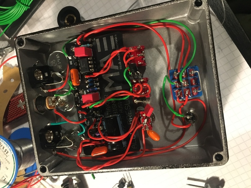

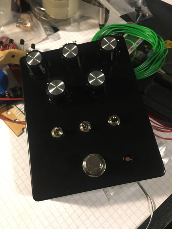

This is my "Perhaps?!" fuzz: built using MAE Business Card PCB, it's basically my own mix of Yes & No fuzz pedals.
Controls (left to right, top to bottom): Volume, Tone, Yes' More, Octave, NO's Thud.
Switches (left to right): 386 low-high gain, Q1 PNP/NPN switch, 3 position Yes' Splat (1nF, off, 10nF)
Stil trying out some transistor, but it's a messy, funny fuzz!

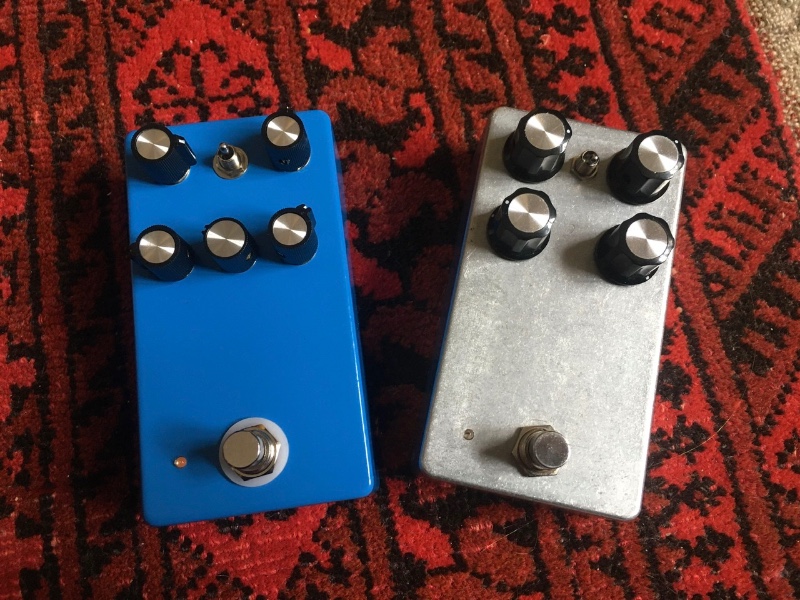

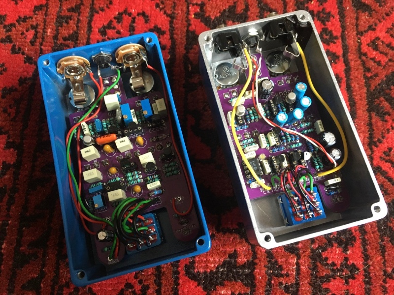

Fresh from the workbench a pair of Infanem clones: blue Driving Notion and bare aluminium 141G.
141G: straight forward build. I went for the G version, but I did a tweak as I installed 4.7uF NP caps instead of the 10uF, as I felt the sound was a tiny bit too boomy/bassy (but in a good way), and played a bit around with the transistors to get a different texture than the stock 2N2222.
Driving Notion: I did some tweaks in the High part of the circuit: I used sockets for R30 and ended with an additional 2n2 cap in this slot, as it adds a nice extra grit to the distortion. I socketed also C12, as I found a pair of schematics with different values for this cap and the stock 1nF was a bit too much glassy/high-piercing for my taste. I ended with a 47nF, but already 10nF sounds way better than then 1nF, IMHO.
As usual: big kudos to Deadend FX for the stellar PCBs!

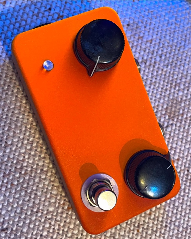

I rehoused a ggg orange squeezer kit I put together 16ish years ago… not showing a guts shot.. I barely got it all in
the pedal was originally the normal Mxr layout… the enclosure is recycled from another old project that I never really liked… only mod to the design was I changed the input cap for a larger one so it works better on bass.. I painted it with orange safety paint

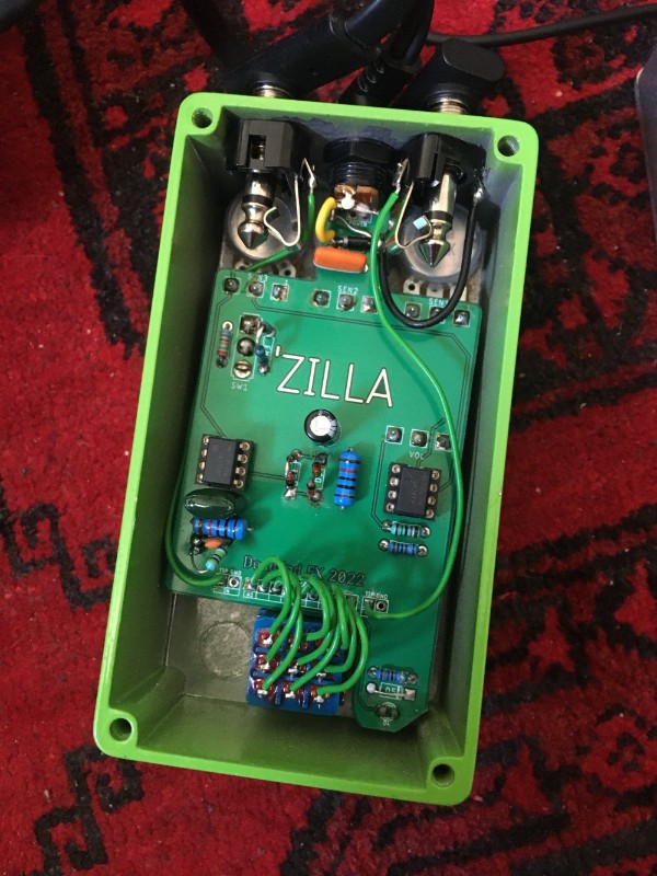

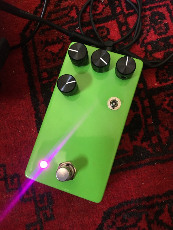

Put together another stellar PCB by Deadend Fx: this time the Zilla, aka the Lastgasp Green Monster clone.
I did used to own an orginal at some point (of which I took the detailed pictures that Deadend used to trace the pedal!), then Deadend sent me a pcb as a thank you for the pictures, I built the clone (which is spot on as the original). So I sold the original, and kept only the clone, which... I sold too at some point..
Lately I was craving again for the rotten tones the Zilla/GreenMonster can generate (also to compensate a GAS I was having for the Mattoverse AirTrash), so I ordered a new pcb and built it again. On this one I did few tweaks to have a bit more disgusting range available:
C4 120n
R7 680k
R3 7M (4M7+2M2)
R5 15k
D1& D2 2x 1N4148 on both sides
Sens1 & Volume 100k
C4 120n
R7 680k
R3 7M (4M7+2M2)
R5 15k
Sens1 & Volume 100k

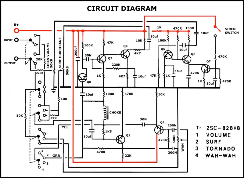

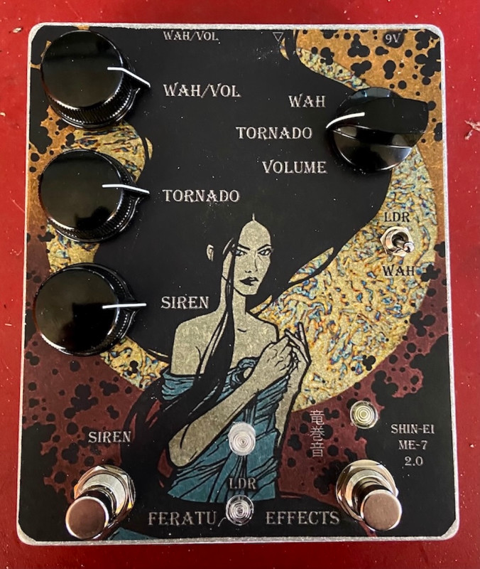

On one of my strolls through the impressive catalog of dirtbox layouts I stumbled across a strange kind of Japanese late 60ies thing, the Shin-Ei ME-7, a "multi-effect". The idea behind this thing is far out: "Let's make a wah and volume pedal, add some white noise generators and to top it off let's throw in some siren sound that mimics air raid horns".
Here's the schematic, that was inside the pedal.
Apart from the 8 tranistors and the transformer, it calls for a 4P4T rotary for the 4 modes, but as the only guy (thanks Ian!!!) who did comment to have built it mentioned - "Hurricane is pretty loud, surf is quiet, Wah isnt bad and siren is instant 'Blockbuster' - The Sweet!!" - and I couldn't seem to find a 4P4T, I decide to ditch the quiet Surf setting.
As for the Wah/Volume part, I went for a potentiometer and installed a exp/vol input for that. Works fine with my Moog.
Then I also added a toogle switch that let's you choose between the potentiometer or a LDR, placed between the footswitches. When engaging the LDR, a bright white light (with a trimmer for brightness) goes on and you can use your foot to control the Wah/Vol potentiometer. Works, but the sweep is not as good as with the knob or the expression pedal.
What else? Ah yeah, the Siren. I put that on a momentary footswitch. It's present on all 3 modes.
So, when in Wah mode, it's, well, a Wah. And in Volume mode, its a volume pedal. I kept those modes, although they are nothing special, I'd say.
When in Tornado mode, the Wah/Vol potentiometer changes the pitch of the white noise. This mode is my jam.
Here's a short taste of this mode at the end of this post, using my "bass test loop":
https://soundcloud.com/fuzzonaut-1/shin ... nado-siren
The "Siren" and "Tornado" knobs are volume.
Finally, after some initial testing, I added a LPB-1 boost at the end.
