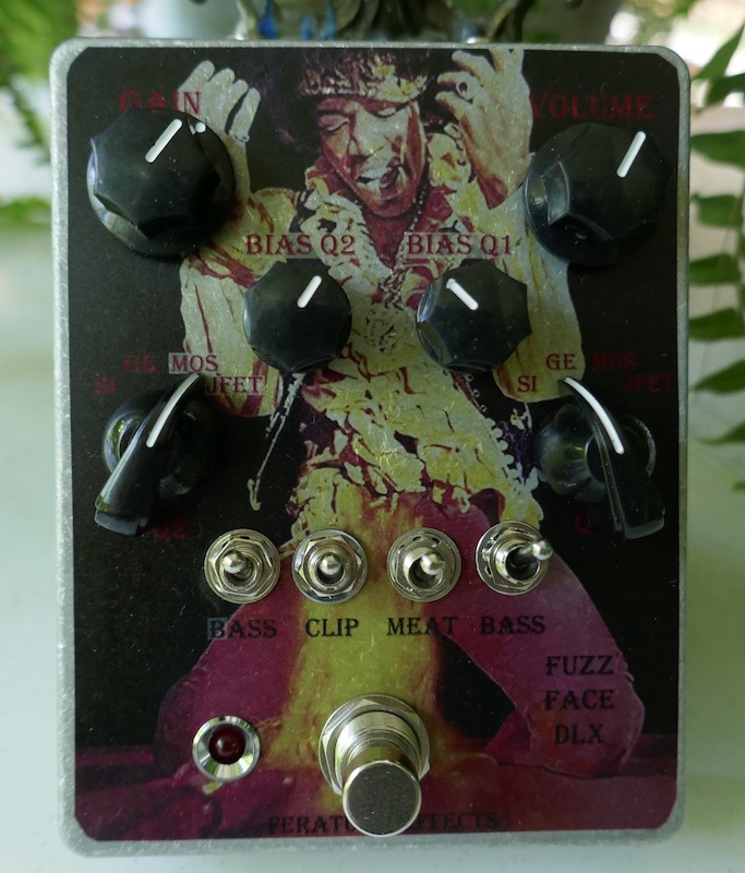

A Fuzz Face with options.
There's your Gain and Volume.
Then each transistor is on a 4-way rotary (GE, SI, Mosfet, JFet) with its Bias pot.
And switches:
2x BASS: 3-way, gives you 3 different caps on the input and the output.
CLIP: 2-way, switches feedback resistor for clipping diodes (à la Bazz Face)
MEAT: 3-way, adding caps. middle is classic Fuzz Face, up à la Colorsound One knob Fuzz, down à la DAM Meathead.

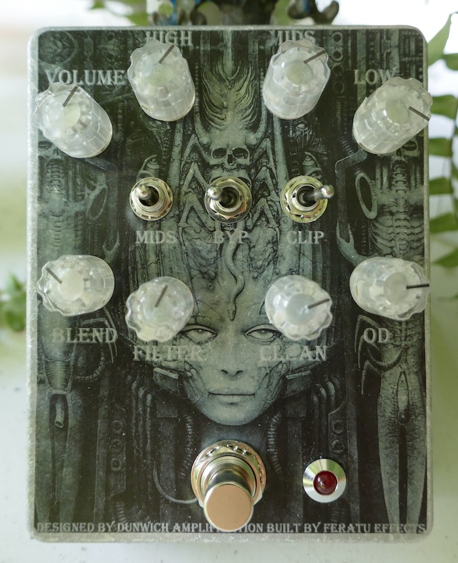

Moar Dunwich Design DIY: a Bass OD.

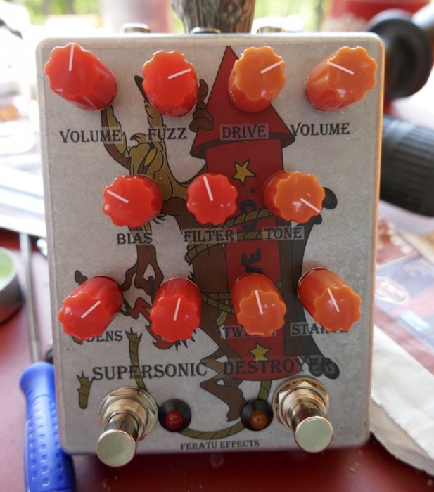

Supersonic Fuzz Gun (red knobs) and Great Destroyer (orange knobs)
--> SUPERSONIC DESTROYER !!!!
An absolutely amazing and crazy box of fuzz madness that can oscillate like nothing else I've heard before. It can also do straight dirt, of course.

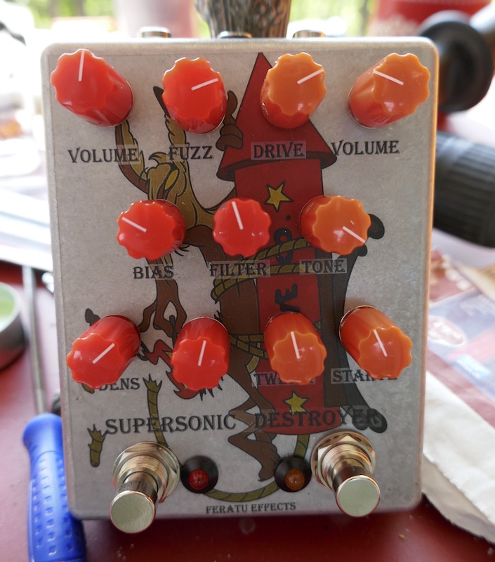

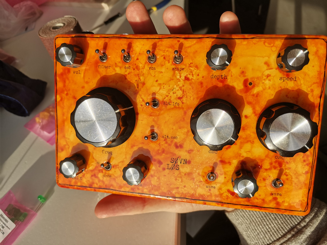

My gift to Heraclitus Akimbo for ILFSS: Søvnløs
Søvnløs is an axoloti-based drone box which can also function as a somewhat limited modulation and filter FX for incoming signals.
Demo:
Controls:
Planning and build pics:
