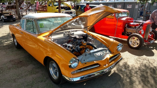

Mopar powered Studebaker:

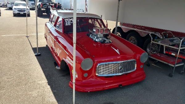

Rambler
-Ring Mods!
