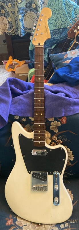

for experimental purposes i fitted the old neck from the Jazzmaster to the Telemaster body. i ordered a $30 10kΩ Tele bridge pickup that should balance the 7.2kΩ neck mini-hum and overcome some of the shrillness inherent im an ash body. the big problem is that the neck bolt holes are wildly out of whack, both position-wise and running diagonally. i may take this out to Charlie’s tech and have him do it because i have little confidence in my ability to do a lot better. i like the TM much better with the JM headstock. i still don’t know if i want a Telemaster, but since the total cost so far is $40 i can’t really resist finishing it. it has a vibe…i just don’t know if it’s my vibe. it seems more like a Keef guitar than a me guitar.

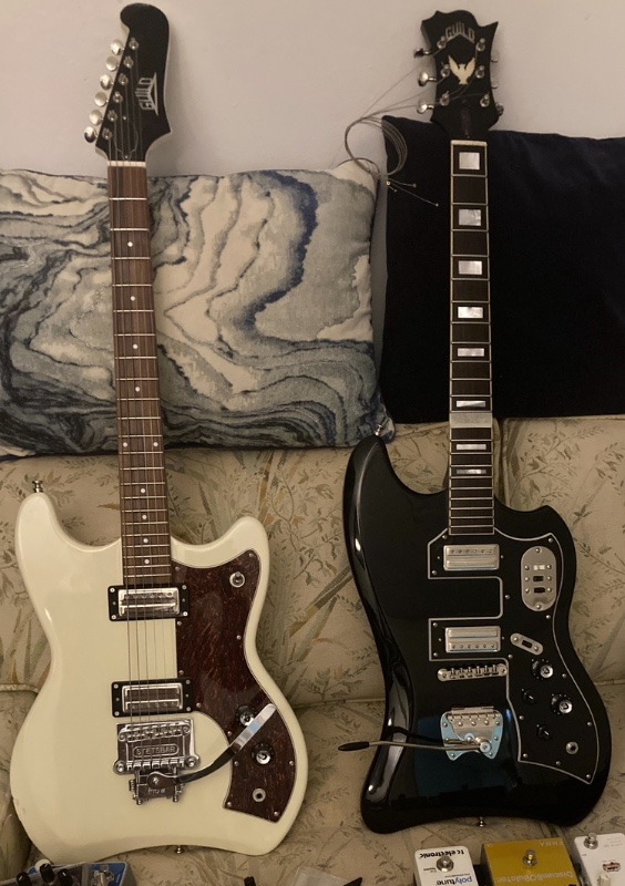

it’s been quiet the last couple of weeks in Project Land. still working up to bigger stuff. decided to level the frets on the T-Bird because i couldn’t get the action low enough to be acceptable, and i don’t keep my guitars super-low because i pick so hard. i thought i’d have to do the Jetstar too, but did a new setup and got it quite lower than my typical string height. it really only needs the paint done, which is why i got it out to encourage me to deal with it. i really like it…it’s like what would happen if a Strat had a baby with an SG with mini-hums, and you know mahogany slabs are my favorite. i looked it up and i currently have five, eight if you count the 3 DeArmonds which are all mahogany (or nato…sources differ).
don’t the Bird and Jetstar go well together? i could really confuse people by using them as the 2 guitars i’d take for a sit-in/gig.

i want to A/B them because they seem to sound more different than you’d expect from two mahogany bodies/necks with the same pickups. the reissue pickups are weird in that they used a vintage set to duplicate which had a weak bridge pickup, so the bridge pickup is like 5.5kΩ while the neck is over 7. i swapped the pickup positions on the Jetstar, but so far haven’t been willing to dive into the much more complicated wiring on the Bird. i should open it up and see how weird it is. the Bird’s bridge pickup is kind of reedy compared to the Jetstar. the eventual solution would be having the pickups rewound, but that’d be well down the road. the current pickups aren’t optimal, but they do the thing so it can wait.
all the Jetstar needs is the paint work, which i would like to get done. it’s just a question of masking off the edges of the fretboard, doing a primer coat, sanding it down, and doing the color coat. it’ll probably need a coat of clear poly to match the original finish, but we’ll see. i’ve been leaving this off because i was bummed by the previous attempts/failures which often makes me averse to doing more on a particular project.
