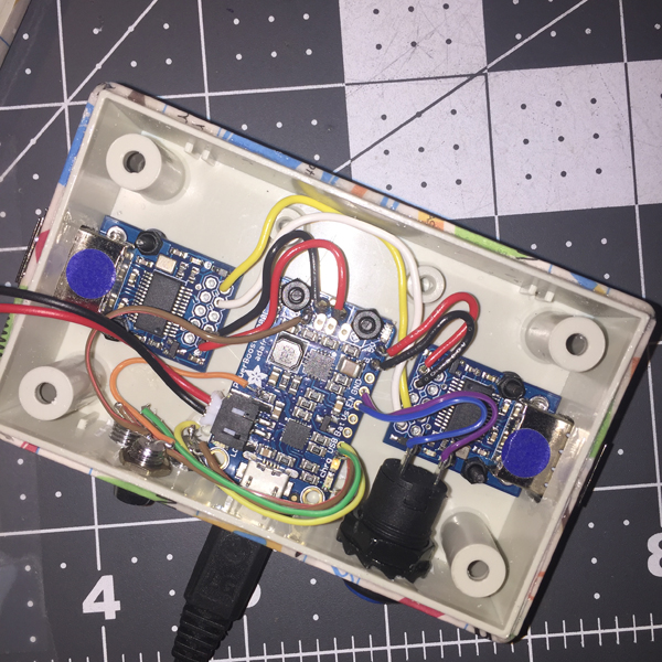

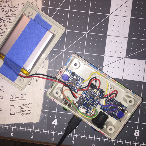

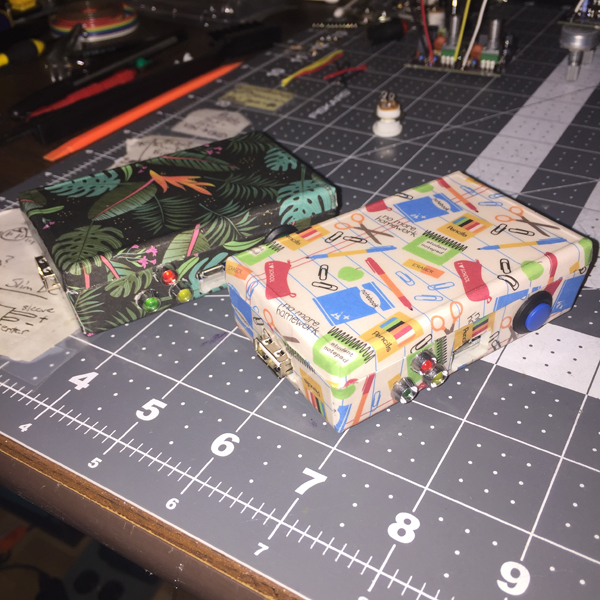

heres a couple Dual USB Midi Hosts i put together yesterday
someone over at the op1 forum hipped me to this concept
of simply connecting 2 host boards together, and they communicate brilliantly.
pretty much all the USB Host things i've found out there are all USB > DIN or way overkill so being able to go USB > USB is rad.
the best part is if u are looking for USB to DIN conversion,
u simply plug in a class compliant USB to DIN adapter on one end (i have a iconnect mio)
and viola! so its super flexible.
hooked up a 2500maH LIPO battery so its completely portable and its about the size of a cigarette pack
should give me 185 hours on one charge by my calculations :!!!:
