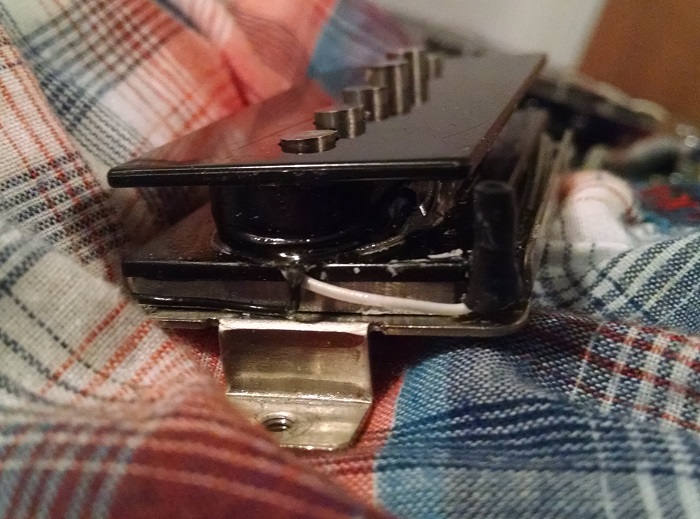

by imJonWain
I took a SD phatcat I had and turned it into a quasi EGC/TB style pickup. I removed the bar magnets underneath, drilled out the pole piece holes and put in some alinco5 rod magnets from an old telecaster neck pickup i had. Then I machined a steel plate to fit under neath and around the magnets. I like it so far, sounds like a fat bright loud single coil haha.

Posted: Sat Dec 24, 2016 10:54 am

imJonWain wrote:I took a SD phatcat I had and turned it into a quasi EGC/TB style pickup. I removed the bar magnets underneath, drilled out the pole piece holes and put in some alinco5 rod magnets from an old telecaster neck pickup i had. Then I machined a steel plate to fit under neath and around the magnets. I like it so far, sounds like a fat bright loud single coil haha.
This is amazing
