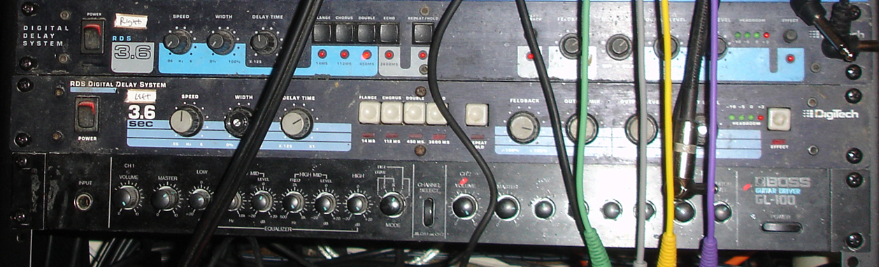

rfurtkamp wrote:The venerable Digitech RDS rack delays rock for this.
The sample+hold is independent of the LFO and changing the delay time/length of the sample is non-destructive - so you can go around mutilating the hell out of it, and going back to where it was.
There's a reason I still have two in my rack after all these years.
Which RDS model should I look for?
Any of them will work - there's two variants in terms of production across the line and I've seen variants of every delay length in both versions.
Grey button and black button (see below, I happen to have one of each of them)
Grey button has (duh) grey buttons with larger knobs. I like the LFO section in that particular one a little better, but they vary a bit (age more likely than production specifics).
Black button adds linking blinking to led delay time (useful to match when wanting to return roughly to where you were before - but useful only on longer times for that as short ones just light the thing up solid) and invert feedback button, at the price of smaller knobs (harder to adjust in real time discretely by just a little bit due to spacing more than the size).
The number after indicates the delay time. 900 is 900ms (yawn), 1900/1.9 is 1900 ms 3600/3.6 is 3600ms, 4000 (never saw a 4) is 4 sec, 8000 (no 8 exists to the best of my knowledge) is 8 sec. 8000 has additional stuff but is EXPENSIVE and relatively rare when it appears.
There are internal trimmers to adjust delay length and LFO stuff if you're wanting to get crazier (take photos of existing setting first, trust me on this) or up the delay time. On the back of the rack, you've got the usual options for on/off or repeat/hold trigger footswitches (can be done by the front panel), various outs (Mix, dry, phase, etc).
3.6/3600 is the workhorse of the lot, 1.9/1900 is the budget, and the 900 is "just why?" in this day and age, and unless you get a smokin' deal on the RDS-8000, stay away because you can usually get a half dozen 3.6s for what they cost (wish I was kidding).

rfurtkamp wrote:
Cool. Thanks for this info! I have a lead on a black button 3.6. Hoping the guy will do $85 shipped.
