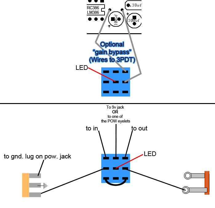

Alright so I'm fairly new at making my own pedals and I decided to take on the double footswitch version, but I'm not quite sure how to wire up the second 3pdt switch. I've seen a couple pictures of the fingerprint gutshots and I can pick out 4 wires, the two from the board, one to the LED, then I can't tell where the other one goes. Can anyone help an ILFbrother out?

transients wrote:Alright so I'm fairly new at making my own pedals and I decided to take on the double footswitch version, but I'm not quite sure how to wire up the second 3pdt switch. I've seen a couple pictures of the fingerprint gutshots and I can pick out 4 wires, the two from the board, one to the LED, then I can't tell where the other one goes. Can anyone help an ILFbrother out?
Here's one way to do it.
Power goes to the same lug (middle front) on both 3PDTs.

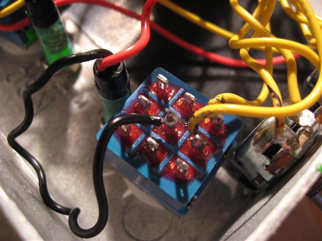

Alright, I've got the pedal working and I've got the gain bypass footswitch working, BUT the gain LED doesn't turn on or off. I have the positive wire going to the same spot as the main bypass LED's positive is going to (the 9v adapter, and the main bypass LED works) and the negative to the middle lug of the 3pdt, just like on the diagram you posted. I put a wire from one of the pow pads of the circuitboard to the bottom middle lug but it didn't change anything so I took it out. I'm pretty close to a total noob, so it's probably something really dumb that I don't understand about 3pdt switches :picard:
The POW eyelets are for "power out"...run one wire from each POW eyelet to the front-middle lug of each switch. Then the red wire from the LED goes in the middle lug of the switch.

ahhh duh. :facepalm: I wired up my other bypass switch slightly differently so I was in black-wire-to-switch mode, totally didn't catch that they were red on the diagram! that's what I get for trying to make a pedal at 2am :lol: but now it's done and working completely! and it's quite awesome might I add.
