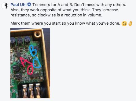

Sooo can you tell me how to make my Brothers pedal louder? Like which trimmers do I turn? ;)

by PeterBregman
Jesus Was a Robot wrote:Sooo can you tell me how to make my Brothers pedal louder? Like which trimmers do I turn? ;)
My buddy Paul Uhl made a good diagram/description for the CBA FB group:
Screen Shot 2017-12-09 at 4.28.20 PM.png (102.66 KiB) Viewed 4786 times

You know what's funny. I just remember Jack already told me how to up the volume. LOL. Thanks for that post though Peter!
