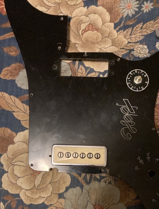

oh happy day...i forgot that there's no can on the Twisty controls. this opens up the wiring options considerably. i need to see if the Jupiter pickups will stretch far enough on the harness to reach the cutouts. if that fits i'll need to figure out how the volume control and jack are wired...everything about this setup is literally foreign to anything else i've ever worked on. the shielding on the pickup wires runs all the way to the jack. it sure is grounded well, though. i guess RF interference must have been a big problem playing in the BRD.

so i figured out that i can take the pickups + switches assembly out of the Jupiter guard and attach that to the Twisty volume control and jack with only three soldering points: hot lead from the switches to the volume control, pickup leads shielding to jack GND, and from the switches to GND. i got the pickups out of the Jupiter guard and it appears that there's JUST enough wiring between the pickups to stretch the added distance between the pickup positions on the Twisty guard (about 0.4"). so now i have to disconnect the Twisty pickups and switches, and then figure out how to configure the pickup mounting apertures in the guard so they fit. that'll be the hard part. after that theoretically all i should need to do is solder 3 terminals, get the bridge out, and string it up. i'll be ordering some StewMac shiz for finishing work, and one of those tasks will be stabilizing the areas of the Twisty body where the finish is totally scraped off. i'll probably end up using brush-on clear coat, but plan on trying touchups with one of their clear lacquer paint markers which is waaaaay easier to control. i'm probably not going to have it playable this weekend, though...Becky has designs on me for Valentines' Day, and Saturday morning we're picking up her new puppy after which i need to make up work hours from taking VD off so a lot of the next few days is spoken for. i'm also going super slowly because i don't want to screw anything up. i particularly don't want to get lost in the arcana of German guitar wiring if i can possibly help it.

i got the bridge pickup cutout finished. i’m having to move the center line of the pickups about 3mm in from the top and bottom edges to allow for clearance since they’re bigger than the old pickups. i’m leaving it here for now because i need to rest up for tomorrow. sometime on Saturday i’ll do the other cutout and drill new holes for the mounting screws; after that there’s the aforementioned three soldering points, and if everything’s working then i’m essentially done other than setup and finish issues. oh, and i still have to file the shaft on the volume knob so the knob will fit.

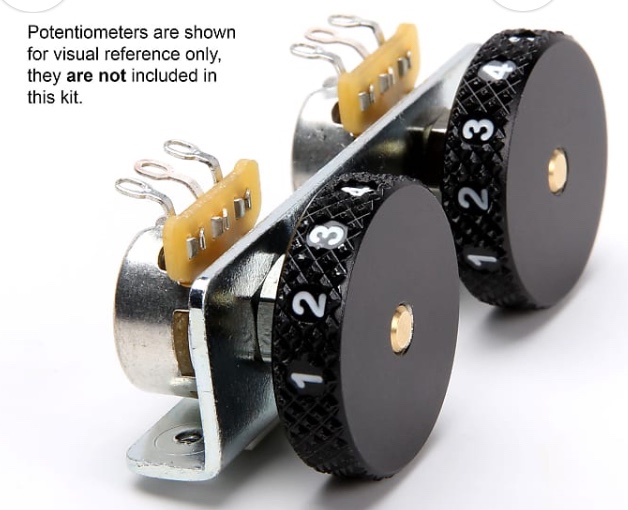

in other project news, i’ve been working on the concepts of wiring the Galaxiemaster. i found white rollers for Jazzmaster parts so i’ll do the pickup volumes as originally planned and white on/off switches for each pickup. i should be able to fabricate 3 roller pot brackets from 2 Jazzmaster or Jaguar brackets (they have different distances between the 2 pots that attach to the bracket) which i’ll need to do to get the pots to line up with the ends of the pickups. when i’m done with the Hopf i want to investigate the most severe automotive polishing compounds. i saw one at O’Reilly that specifically said it’ll take out orange peel texture, which is a GFS body thing. if it works i’ll consider using a similar quality/price level body for my off-in-the-distance Tele and Strat builds, otherwise it’s back to buying used Fender bodies. i’d rather get Strat bodies that have the tremolo mount screw holes already done. the grain filler is ordered so I’ll be able to finish off the Höfner neck, and i can graft in the extra Schaller/Hopf tone switch no problem. the hardest part will be laying out the pickguard, which i can’t totally do until i fabricate the brackets and buy the switches so i know how they’ll mount. i have lots of pickguard template printouts, so it’ll get done. when that guitar is done it’ll be a huge load off my mind, and the culmination of a process that started when i bought a pair of Höfner staple mini-hums off eBay in 2012 because Neal out of Slowdive used to play a Galaxie in their early days, swapping with a Rickenbacker 360.

i made a short list of items i need to figure out pickguard item placement, including one roller pot assembly (with bracket, pots, and wheels), one Fender slide switch, one of the pickups, and the Schaller tone switch. that’ll be down the road a bit because i’m not doing pickguard stuff till after the body and neck are ready.

i got the other pickup cutout on the Hopf guard done. i'm going to chill for awhile and then drill the new holes for the pickup mounting screws. once that's done i should be able to connect the pickups/switches to the jack and volume control, check that signal's passing, and then put everything together, put the bridge on (i'm going to let it float since it's non-compensated), and string it up. i'm going to clearcoat the parts of the body where the finish is worn away before it's "done." i like when "done" means actually done. i reckon i'll do the Kondor next. i may try filling some of the chips around the edges with the StewMac black paint marker, but i'll try one inconspicuous spot first to see how it works. we're coming along here.
note: the neck pickup is straight; for some reason the pickguard edge where it meets the butt of the neck is slightly diagonal.

the pickguard is now physically done…drilling the screw holes for the pickup screws was trickier than it sounds, and i did a lot of filing with my tiny round file moving holes to where they needed to be and making them large enough to fit the screw diameter. once that was done i mounted everything on the pickguard and put the paddle switch levers on. i had to file down the shaft on the volume knob to fit the Hopf knob from the Jupiter guard, which requires a D-shaped shaft. i didn’t want to use the Jupiter’s volume pot because it was a tiny plastic thing.

something interesting i discovered is that the contrasting logo, labels, etc. are engraved through the paint onto the guard and are bare aluminum, not white as i thought. i tried rubbing some white grease pencil into the logo thinking it could use some help but that actually made it look worse, accentuating the unevenness of the engraving. sometimes working on these 60s foreign guitars is a very strange revisit to an extremely different world.
