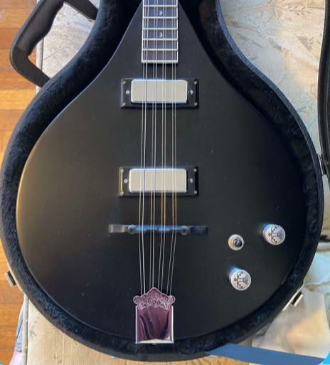

this one here:
i like the semi-industrial finish better here than on the bouzouki. the completely flat surfaces of the solid body really show fingerprints. in general i try to avoid black guitars for this reason, but if you wanted a Gretsch Jet before the mid-00s when they started making other colors consistently you got black. at least you could get white Les Paul Customs.

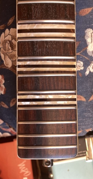

i finished the Hopf neck. i'm happy with the result. next i'm going to do the Höfner neck while i have my chops up, alternating with changing the autoharp strings. i'm really pleased that i got it done before i intended to. tomorrow i'll mount the neck to the body so we can see it as a whole guitar.

been working on the Höfner neck. it’s more challenging than the Hopf for a couple of reasons…the fingerboard is much more radiused than the fairly flat Hopf board, and it’s also been played on quite a bit, meaning that the surface is more pitted, dinged and cracked and thus more difficult to get entirely smooth. the frets are also more “jumbo” (tall/fat) so they tend to be more challenging to tape off with masking tape. i don’t have any good ideas about how to fill the pits etc. so for now i’m just getting it as smooth as i can. i’m dubious about using grain filler because it’s not going to improve that much.
i reworked the first (19th fret) set of stripey celluloid pearloid/tortoise/pearloid binding strips. getting the markers flat ends up with the plastic strips being lower to the surface than the wood. when i went over it again i was able to make the transition more gentle. still looks a bit odd close-up, but nobody’s ever gonna put their snoot that close to the neck. hopefully the slight differences in fingerboard level won’t make it play out of tune.

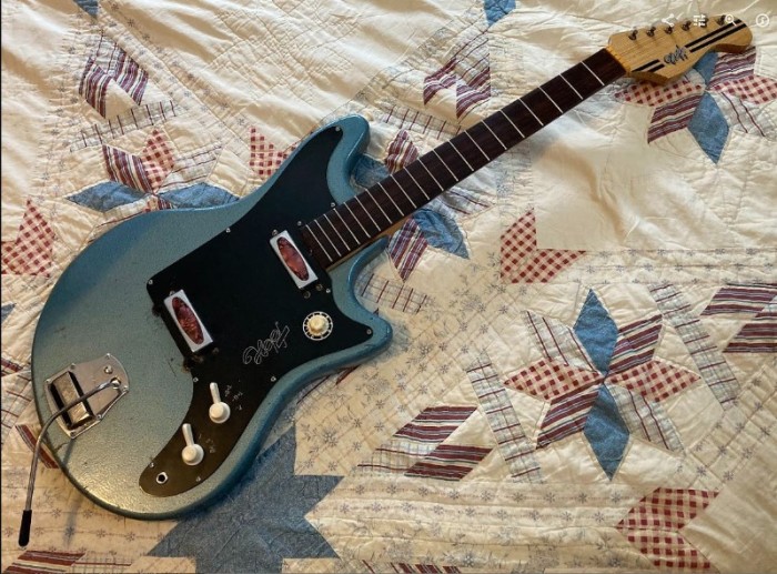

Hopf with the neck on. the original mount was a 3-bolt design, which i filled and redrilled for a standard Fender-sized 4-bolt neck plate when i had the Höfner neck on. in retrospect the reason i couldn’t kludge by with that neck wasn’t just scale, it was that the Hopf is a 20-fret neck while the Höfner is 22 frets. there was absolutely no ambiguity about the neck position, with a straight edge on the pickguard that the flat butt of the neck rests against. you can see scratches in the pickguard where the neck was adjusted via a hex key in the heel. next the guard comes off and i figure out how to transfer over the Jupiter 62 pickups. removed the bad photo; a better one appears below.

as promised, here's a better view of the Hopf made back into a guitar. i'd forgotten how utterly trashed the hammertone metallic blue finish is. i'm ordering brush-on clear coat from StewMac to tip into the big scrapes. it's an odd feeling, holding a guitar with a body that's apparently been to the Ostfront and a neck that's NOS. is this what those over-thought Fender and Fender-esque relic guitar jobs feel like?
the bridge studs for the tunomatic i put on are still there. they're countersunk to the top surface so they won't interfere with placing the correct bridge. they stuck out like a sore thumb, though, due to the BRIGHT chrome finish so i dug deep in the parts box and found some enamel hobbyist paints i'd bought in 2013 as part of early Kondor fun. surprisingly, 10 years in storage doesn't seem to have affected the paint in any way, and they pretty much blend into the pickguard which is also black now that they're painted.
i swapped the paddle switch selectors from the Jupiter 62 guard which are in much better condition that the ones on the Twisty. the volume knob will be a bit tricky...the one from the Jupiter is design correct while the one on the Twisty is so wrong that the numbers around the edge run anti-clockwise to the labelling on the guard. i assume a previous owner put a Framus knob on because it was available. the problem is that the Jupiter knob accepts D-shaped shafts, but the volume control on the Twisty has a round shaft so i'll need to file a flat side onto that shaft to accept the knob. aluminum, no big whoop.
the tricky part will be replacing the pickups since the barkier Schaller pickups from the Planets series are a good bit larger (well, a few mm anyway) so some judicious filing is in the works. i believe these guards use a typical German pickup-wiring approach with a single hot conductor from each pickup inside a shielded braid that shunts signal to ground, so it should be simple to splice the control harness from the Twisty to the Jupiter pickups. "should be." write that on my fuckin' urn.
but given the amount left to do and the fact that i can't order finishing supplies until Friday, the rest could very well be done by the end of the weekend, though there's a Valentines' festivity and picking up Becky's adorable new bulldog puppy that will eat some of my "free" time. i have to balance my need to Have Stuff Finished with the need to take care with all this. waiting for the clear coat to dry will drive me batshit.
having checked because it seems so small, the Twisty will not fit the Mustang/Jaguar flat cases only because the upper horn is too long and i'd have to take out a piece of the divider. so Strat case it is! an important milestone in the life of a guitar project is when it's put together enough to get its own hard case.
fan note: yes, that is the quilt from the 2012-13 photos. the present-day artist refuses to needlessly replace stuff!

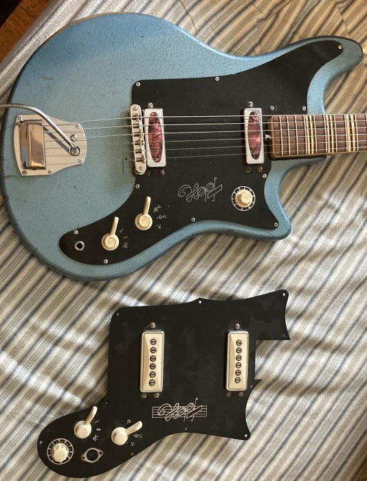

today will be a quiet projects day. i plan to try unsoldering the brass can that shields the electronics on the Jupiter 62 guard, partially to see if i could do that on the Twisty guard if needed and partially because i want to steal the Schaller tone switch for use in the Galaxiemaster. i'm not sure if my iron will get hot enough to do the job without overheating. if it's a lost cause i'll just fabricate a different tone switch with a four-position rotary switch. it's a pretty simple circuit:

i managed to get the can off the Jupiter controls. it wasn't easy, and required that i run the soldering iron as hot as it will go (it overheats at 900°F) to make a dent in the solder. i don't know what kind of solder they were using in West Germany in the 60s, but it frightens me. it should be fairly simple to move the tone switch to the Galaxiemaster...there's a big cap in the circuit that's wired between the pickup selector (center) and the tone switch (at top), which can probably just sit in the cavity with the tone switch. still thinking about moving the pickups and switches in one swell foop, but i'd have to take the Twisty guard off and remove that can, too, so it might be simpler just to graft the pickups onto the existing Twisty harness. yes, it's that much of a pain removing the can.
the pickguards compared, for reference.
you can see that the harness with switches from the Jupiter will fit the Twisty guard, but i'd have to wire the volume knob. maybe that could stay in the Twisty and splice into the rest of the harnesses.
i would be a much happier guy if i didn't have to deal with the electrical side of guitar work. woodworking can be enjoyable; soldering never is.
