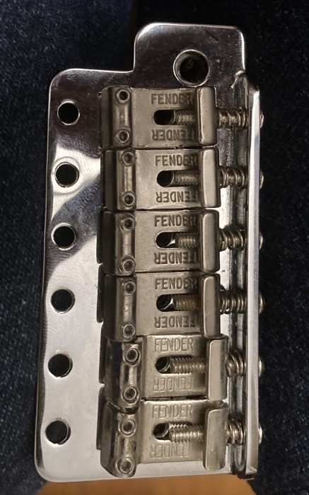

while waiting for the body to be ready i decided to go into my bag of Strat tremolo parts in the parts box and revamp things. the import Fender plate i used is much better-made than the Gotoh plate i was using, better bevels and nicer chrome. happily the Gotoh block fits perfectly.i had some extra saddles as well and changed out the more tired-looking ones as well as swapping out length adjustment screws with chewed-up heads and changing a couple of the height adjustment screws for shorter ones that don't chew up my hand when i strum. the bottom two saddles are visibly different and i notice the new ones are a bit narrower which is good for string spacing over the pickups, so perhaps i should do the others if i have them.

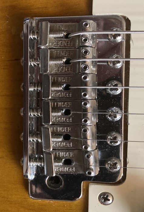

everything's back together now. i didn't get it
exactly right, but it's better than it was and i guess i'll settle for that. it's pushed over a bit to the bass side, which was inadvertent but is good because the high E string is too far from the polepiece on the bridge pickup. taking a break before i do the intonation/string height/pickups.
