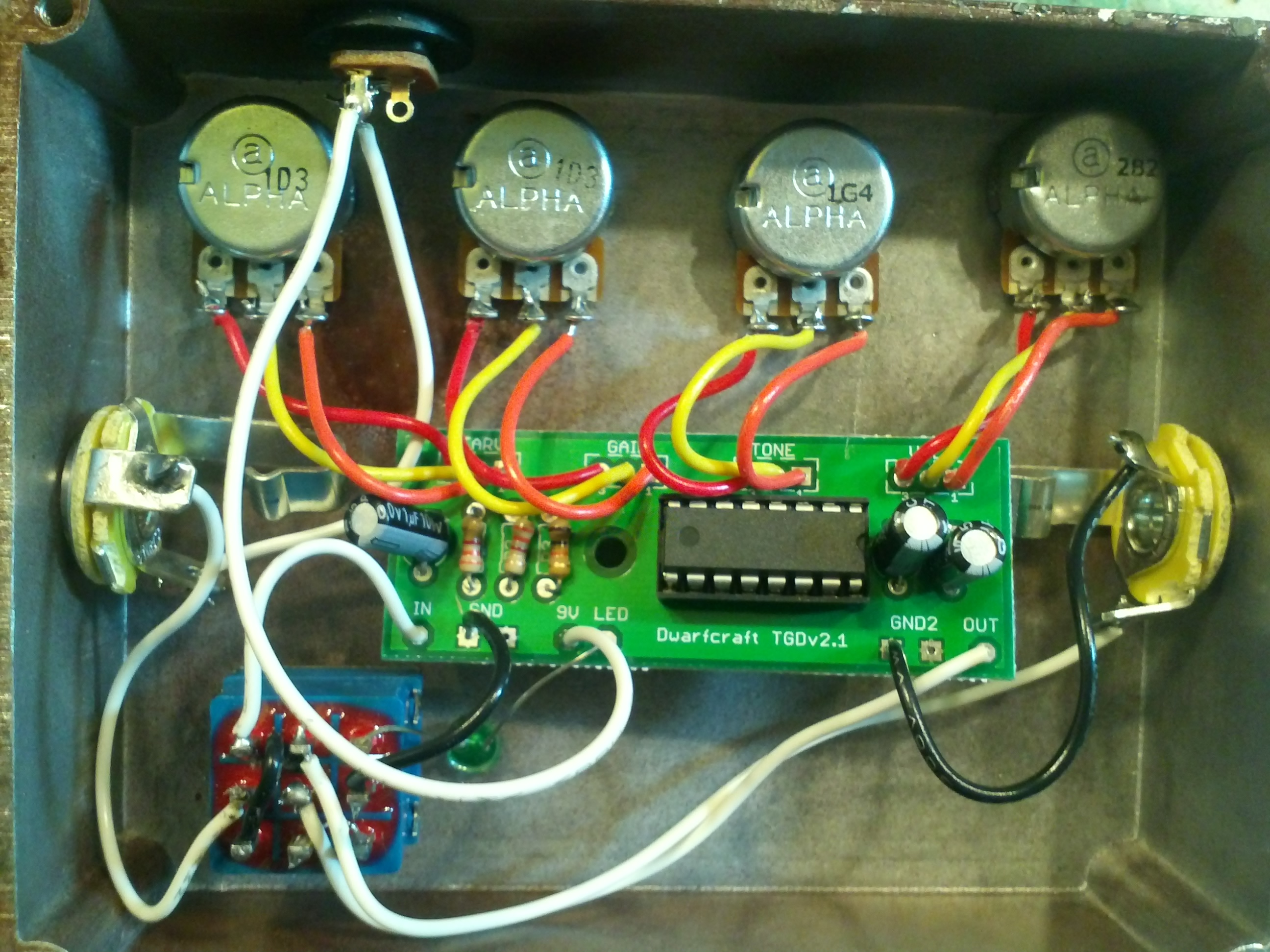

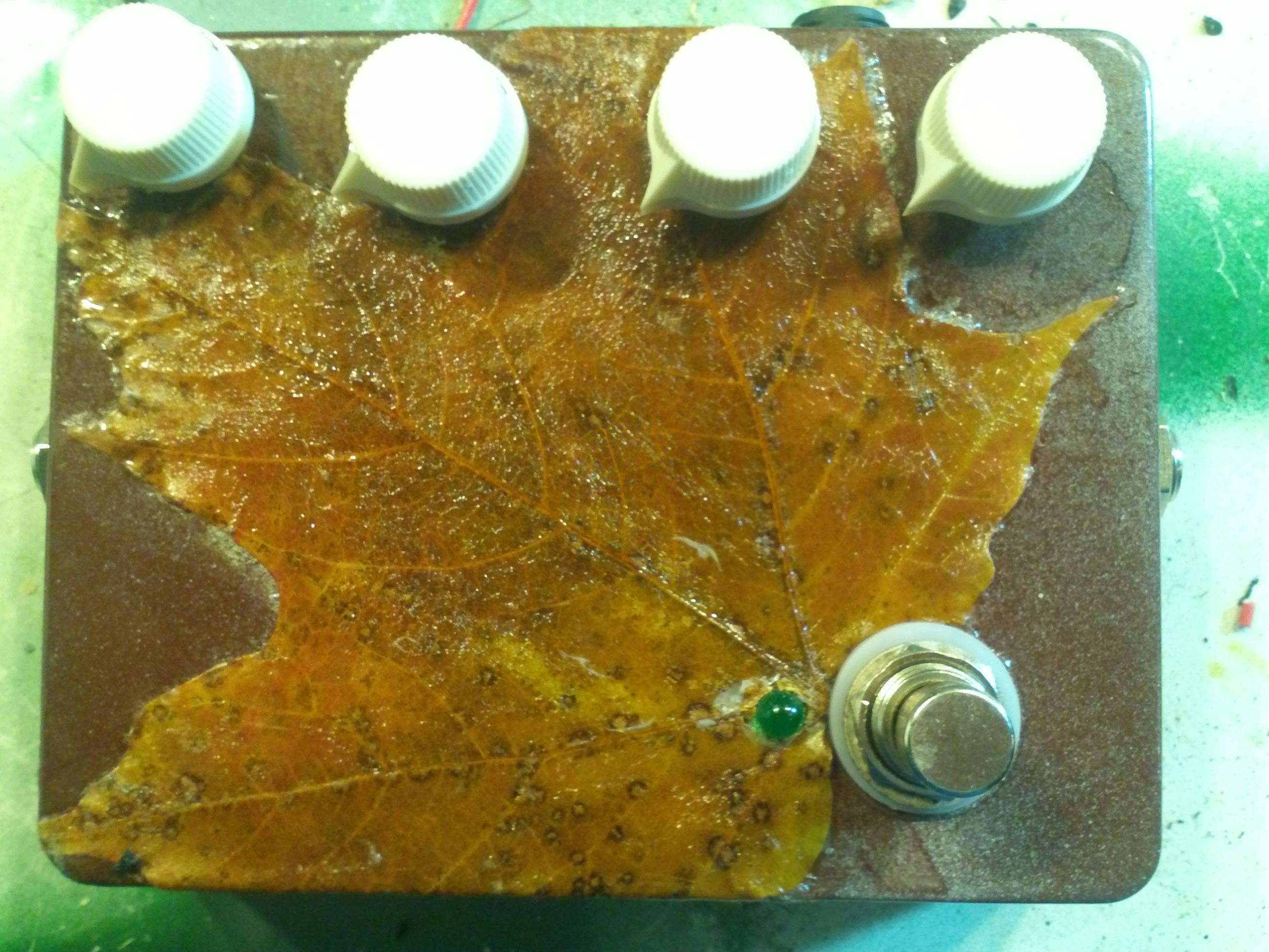

just finished this up
it works
I am not sure how noisy this thing should be and am also running it into a marshall mini stack so I think I have to try it with a big amp before I put the lid on tomorrow
if anyone sees anything I need to change let me know
although I won't get more talented overnight
Re: TGD Build! Ask yo motherfuckin' questions here!
ok most of my noise went away when I put the bottom cover on, does that make sense?
Posts: 18246
I believe the enclosure is the ground in this one. So maybe that's why? Dunno. Can't remember. It's a noisy fuckin pedal though! But in a good way. Try it with the oscillation off.

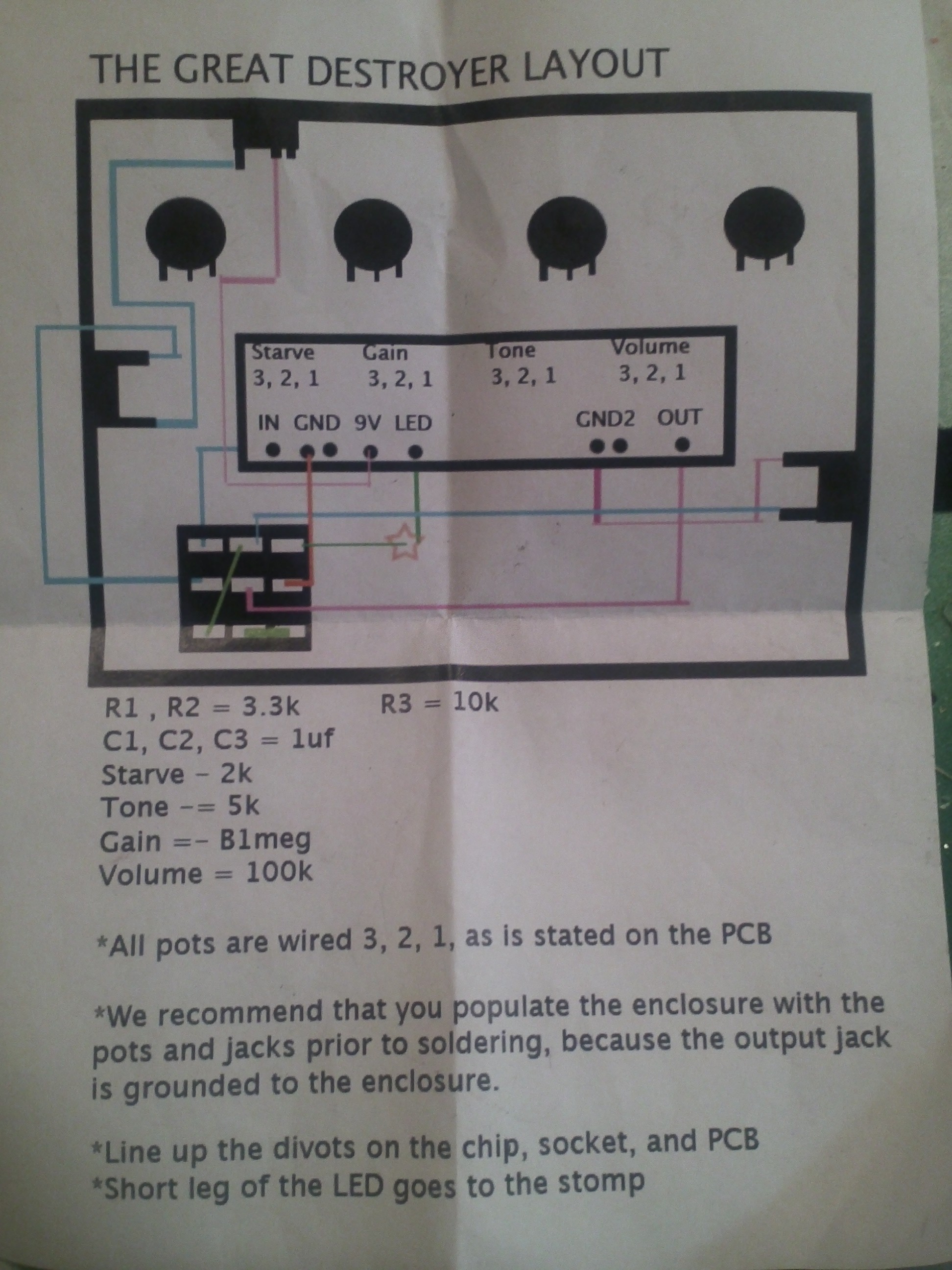

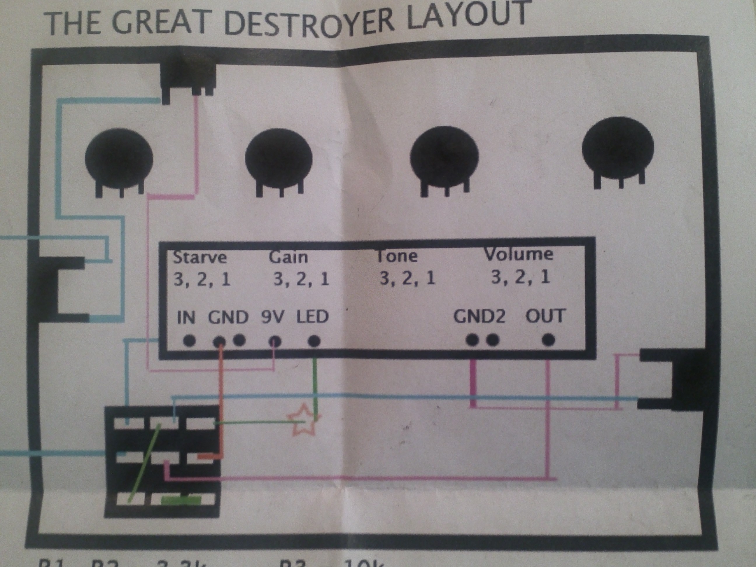

hey, i just got myself this build but left the instructions sheet at my apartment, which i won't be at for a few days.. days in which i plan on building this pedal. could someone take a picture of that instruction sheet for me? :D

stripes wrote:hey, i just got myself this build but left the instructions sheet at my apartment, which i won't be at for a few days.. days in which i plan on building this pedal. could someone take a picture of that instruction sheet for me? :D
yeah give me a few min I will post em here

thanks!! also is it better to install the switch, jacks and pots into the enclosure first and make all the connections to them while they're already in place or build the whole thing and then put it inside the enclosure?
install first and then make all the connections

Pics YO!
