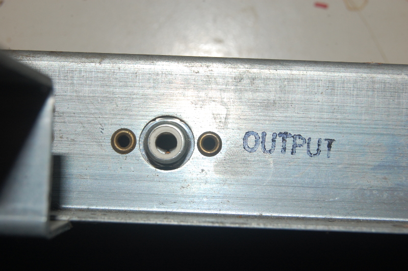

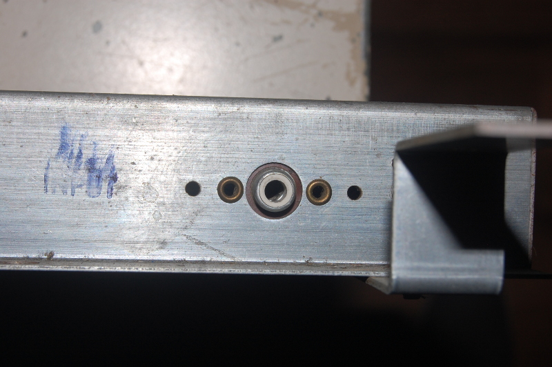

Here's a couple pics of a pan I have, notice that the output jack shield is connected to the pan via a conductive material whereas the input jack is not.
Ben79
Posts: 510
Joined: Thu Nov 01, 2012 6:16 pm
Location: Germany
Re: Reverb power supply
Post by Ben79 »
Yes, same here - output sleeve is connected to the tank chassis.
