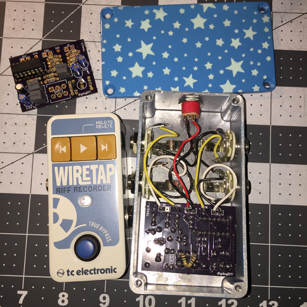

ah heres the thread, i found u!
was inspired by this thread to design/create my own trails pedal.
prolly not the most efficient way to do it but it works nice
thanks for the inspiration!

Sick, what's going on in dat box dere? And who's a bro got to blo to get one?

Re: Easy way to get trails from analog delay w/o modding
basically a powered FX loop pedal. jacks are in & out, send & return
adds trails to anything u plug in the send & return loop.
i do have 2 more boards and one box all ready to go. gunna finish assembling it today.
i could sell u one if your interested...?

Dr. Sherman Sticks M.D. wrote:basically a powered FX loop pedal. jacks are in & out, send & return
Cool, so the difference between this and a regular loop pedal is that the signal from the loop is always active? And does bypass mute the signal to the loop? Or something different?
Posts: 4049
Location: rochester, ny
when the pedal is activated, then your signal travels thru the fx loop.
when the pedal is bypassed, the signal does not travel thru the loop (goes in to out)
but the return is actively mixed w/ the in to the out giving u trails
since the mixing is active (i.e not passive) there is no funky volume drop or anything
hope that helps.

Dr. Sherman Sticks M.D. wrote:when the pedal is activated, then your signal travels thru the fx loop.
hope that helps.
