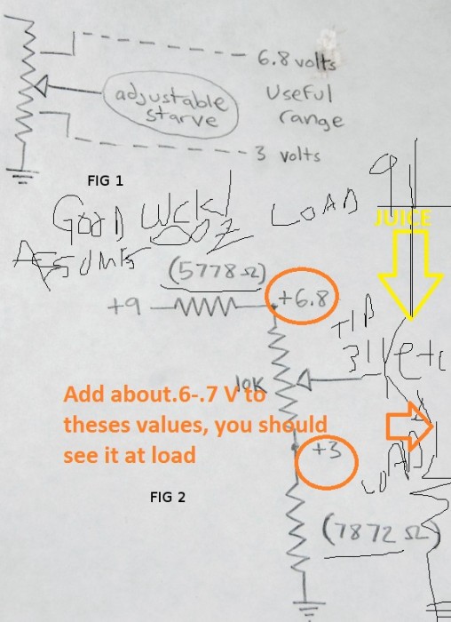

crochambeau wrote:
JonnyAngle wrote:I'll take up your offer on a diagram RMA
Evan, it's just a variable resistor from 9v to 0v
Okay, Fig 1 depicts what you've got with the limited useful window of rotation. The upper point and lower point of rotation will have to be direct measured for the voltages that apply to your unit, I've just tossed a couple numbers there that are meaningless beyond the example.
So, first thing to do is determine the percentage of important voltages (in this case 6.8 is JUST BEFORE you start to observe the starved effect, and 3 is when the circuit falls flat), and know your supply voltage.
Supply voltage is 9.0, so 0.09 is one percent.
6.8 divided by 0.09 is roughly 75.56%.
3 volts is 33.33%
the circuit will make a llel load between the wiper and ground. the measured voltage with nothing plugged in and the measured voltage with something connected will be different. if the load is low in resistance it will be drastically different. by low i mean even close to teh scale of teh resistance of teh pot, so a load of even 5mA or qqc is high.
use a current buffer ?
not trying to come off as negative, just it is not hard to see why a "linear" response is not observed. think about the whole circuit when the load is present.

My earlier drawing has no relevance to the circuit baremountain speaks of. I realize the load down stream will be in parallel with the lower resistor, hopefully the value derived would have come about in the circuit under test and would be a non issue. Agree a buffered approach would be more solid, but cavemen like to play as well.

multi_s wrote:Why even this won;t work for a circuit that draws any appreciable current and why voltage sag is still a dark art that is different with every pedal:
True, I'm still mired in the land of old school electronics that are happy enough to run off a dry cell. In this incarnation the voltage divider sees negligible loading through the gate of the mosfet and the BJT can be somewhat scaled up to support heavier loading. The pot section could just be exchanged for the opamp scaling (and since the opamps have high input impedance and are happy to drive the BE current of the BJT the mosfet buffer can also be ousted).
Those small caps are not going to clean much, so for filtering one would want to plant caps either after R3 to ground, or if some lag after adjust is your thing you can filter the emitter of the BJT (which is supplying the rest of circuit)
