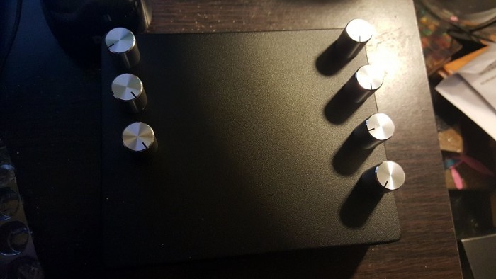

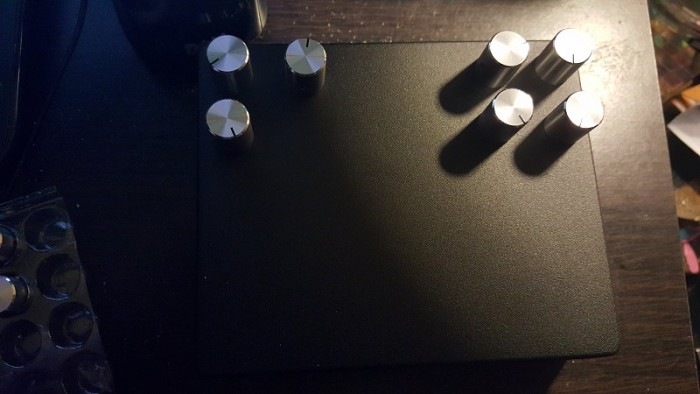

Alright guys, voting time. Which knob layout looks better?
crochambeau
Posts: 2220
Location: Cascadia
Re: I need someone to critique the logistics of a simple pro
Post by crochambeau »
You sticking foot switches in there too? I'd advise not committing a mock up without those (to allow clumsy feet a safe zone).
That said, I prefer lines over clusters - but that's just like, my opinion, man.
DhanoSuzuki
Posts: 52
Joined: Tue Nov 17, 2015 7:01 pm
Post by DhanoSuzuki »
Yeah, two footswitches. If I go with the lines (which is what I'm leaning towards myself), I'm considering maybe putting a metal rail between the footswitch and the knobs on the right. Kind of like those cheap Aroma pedals
But vertical instead of horizontal.
But, I feel like there will be enough room to not have to worry about it. Though, no way of knowing for sure until the footswitches arrive.
