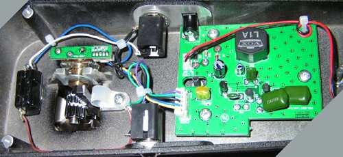

This is a net pic... But this is what mine looks like.
I can upload closer shots of mine later when I get a chance.
This is much different from previous model of. 847. At least from what I've read online and instructive webpages have showed me.

Before the mods.
Parts arrived super fast.

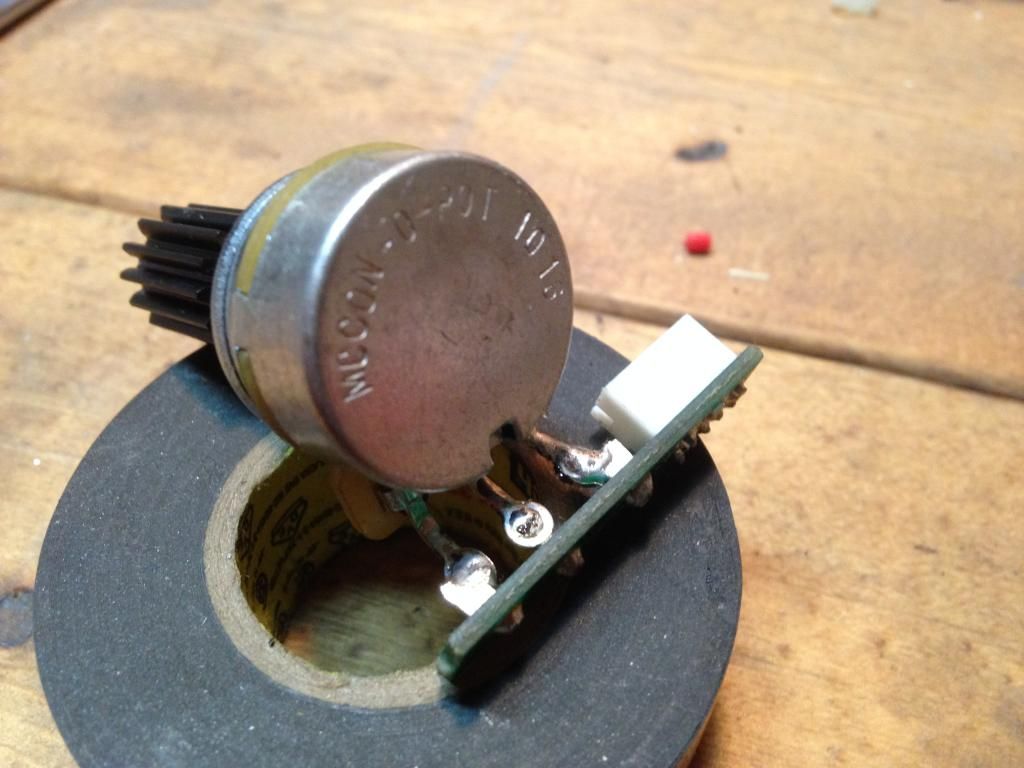

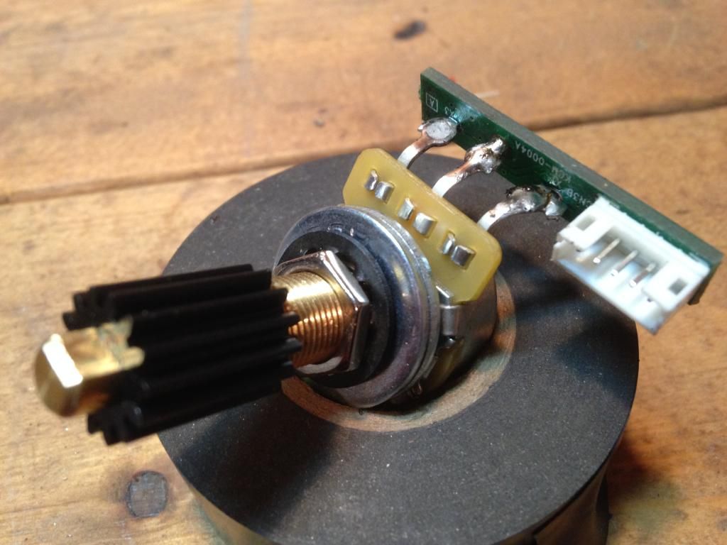

Now the pot. It was a suspected scratchy pot issue at the start... Probably has a little scratch but not like I had before changing out the switch. Soooo ... This highly recommended pot, the mccon-o-pot, should just make the pedal a little clearer.
Most mods said this one sucked due to the pcb on the top. I tin snipped it off close to the pot leaving the tabs connected to the pcb (pcb... Do I have that correct?).
Anyhow. I soldered the new pot to the tabs. Saving a tedious job of unsoldering it.
It's a great looking pot. Heavy.
I just found out he made a sealed pot. Being released very soon.
