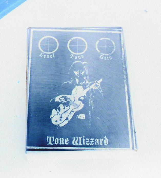

jwar wrote:You didn't invert your graphics. Doesn't the etchant eat everything that isn't painted?

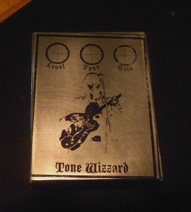

Yes! behold what I hope it will look loke approximately....
Nail polish it is. I fear the fine detail will be eaten, but hey, this is an experiment.
LOL! I realized I was wrong this afternoon. I etched my Robot Devil and it look pretty cool.

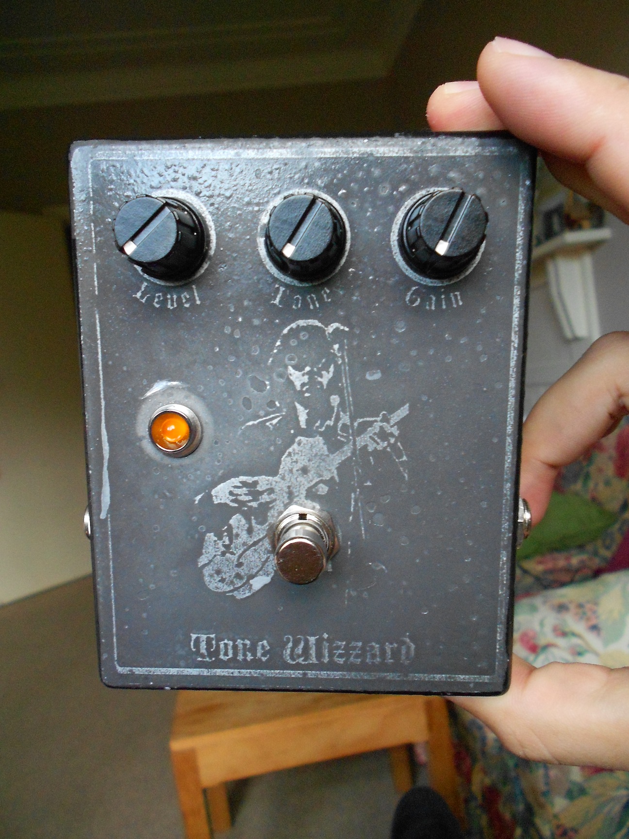

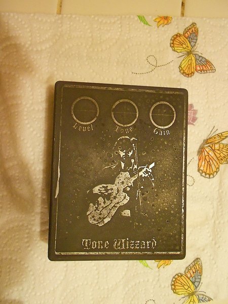

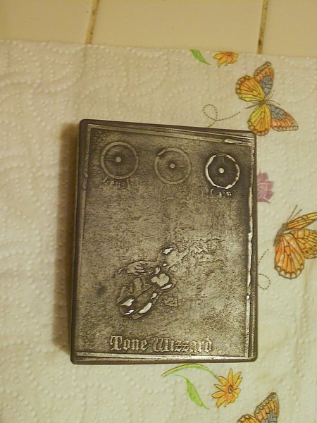

What an afternoon!
I ended up sourcing hydrochloric acid and peroxide from an industial chemical supplier.
I mixed up a vat of 2:1 and dipped my first pedal.
Z0mg!!!!! Within 5 seconds it was bubbling furiously as toxic fumes bellowed upward from the vat! I dunked it in water to cool it, and dunked it in the acid again.
It was crazy meth lab shit.
It burned thru the pnp mask within 5 seconds, and the nail polish i touched it up with in another 5. hmmm
The reaction was way too fast.
So the next one I diluted the acid mix with a few litres of warter. This time it took ages to get the acid to work. Finally I got a reasonable etch, but it looks like it ate thru a casting layer, and its blistered in lots of spots.
The black bit is kinda smudging, but I dont want to sand through it. I think I'll spray it with clear.
Thanks for watching! :thumb:

Thanks for all the help guys.
I'm 75% happy with the etch, and it sounds great.
Thanks for looking in on my first pedal building foray!
