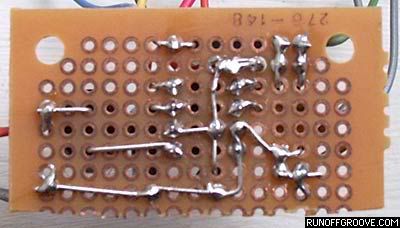

Yes, i'm ressurecting this post. I need help with something that's actually kind of hillariously basic. How do i solder a universal PCB so that the stuff actually goes somewhere? >.<

make a layout on graph paper or download DIY layout creator. you have the schematic. the circuit is simple with only one transistor. do you need help with reading schematics? making layouts is not that hard. you just gotta try and come back here when you get stuck again.

Kellanium wrote:Braaaaaaainnnssss.
Do you mean this sort of board?
If so, just use the legs of the components to make the tracks :thumb:

peps1 wrote:just use the legs of the components to make the tracks :thumb:
this was my first build ever. its not pretty but it works.
