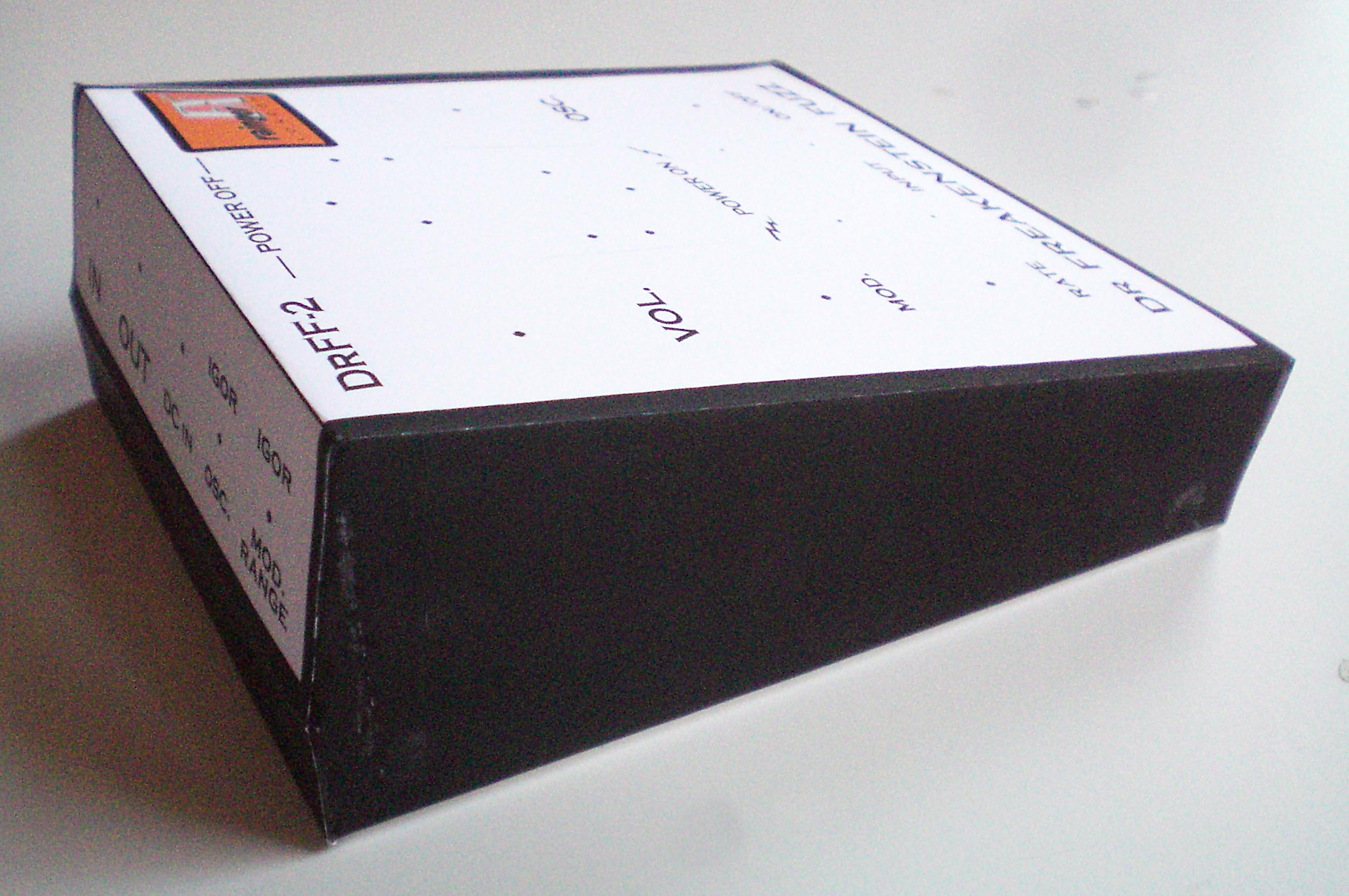

I always made a cardboard replica first - gluing edges together etc, just to hold it and see problems (like baseplate flange).
Here's the cardboard...

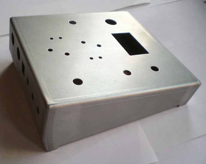

And the box I got someone to make who knows how to do sheet metal folding...

Damn that cardboard almost looks the real deal
