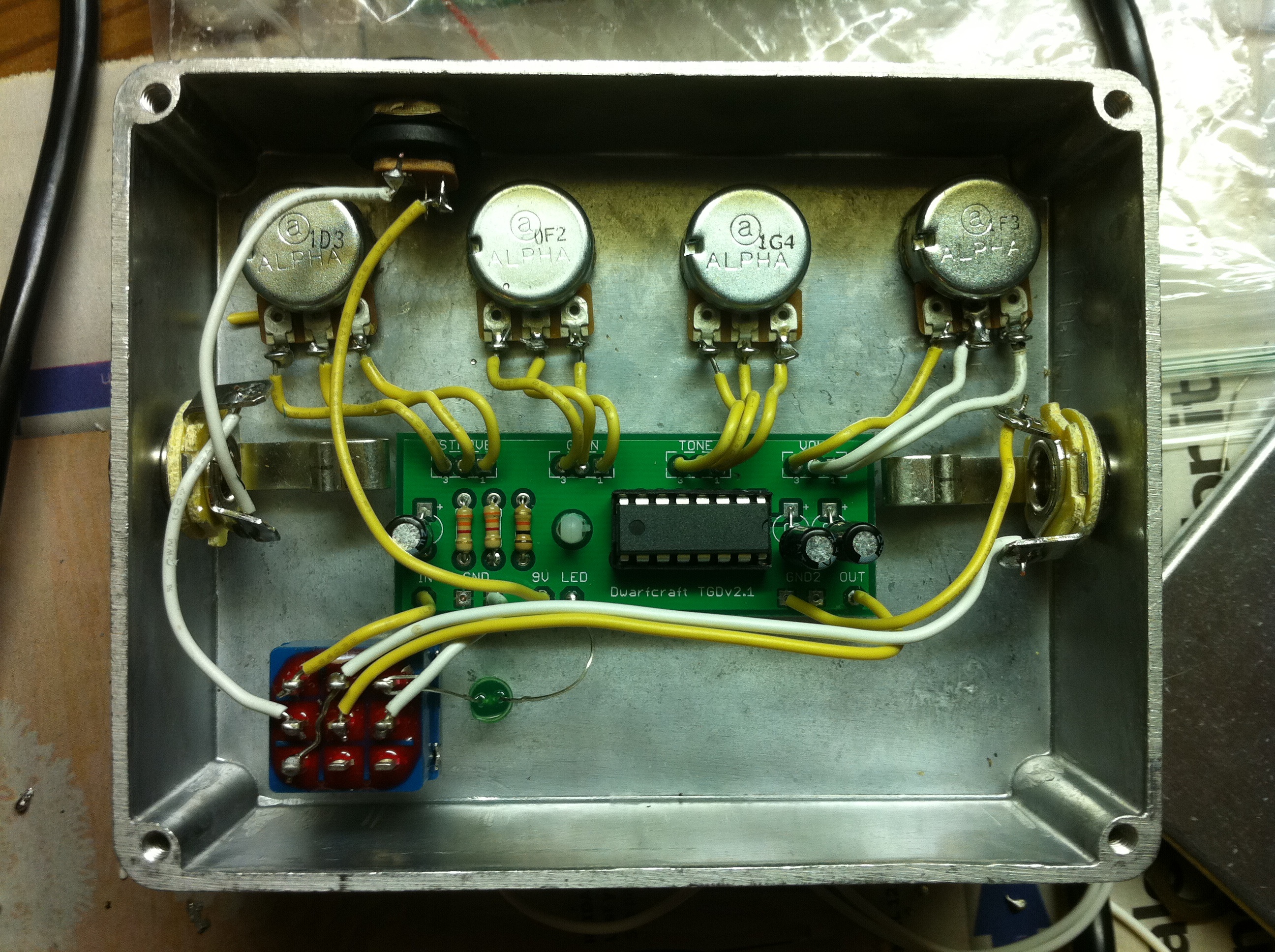

Re: TGD Build! Ask yo motherfuckin' questions here!
johnnie1616 wrote:Sorry it took so long for pics, I couldn't find my camera. I don't have a resitor on the LED but it's working fine now(I had it wired the wrong way around the first time). I also swapped one of the connecting wires to a pot because it was to short. I am pretty convinced it is a bad wiring job on my part but I don't really know how to isolate exactly where the problem is. It sonds like something isn't grounded right to me because when I touch the components and the side of the enclosure the crazy unwanted stuff goes away. But I don't know anything about how pedals work so I could be way off base.
I know it's a couple months too late but I think the ground wire (black) is going to the wrong lug on your 9v plug.
Try switching it to the lug that is not currently being used.
- hazefuzz
- Posts: 122
- Joined: Sun Sep 19, 2010 10:12 pm
- Location: QC
what's the name of the chip???
- fuzzmax
- Posts: 917
- Joined: Tue Apr 06, 2010 7:30 am
- Location: Joliette, Quebec
MEC wrote:johnnie1616 wrote:Sorry it took so long for pics, I couldn't find my camera. I don't have a resitor on the LED but it's working fine now(I had it wired the wrong way around the first time). I also swapped one of the connecting wires to a pot because it was to short. I am pretty convinced it is a bad wiring job on my part but I don't really know how to isolate exactly where the problem is. It sonds like something isn't grounded right to me because when I touch the components and the side of the enclosure the crazy unwanted stuff goes away. But I don't know anything about how pedals work so I could be way off base.
looks right to me....the remaining lug is for a battery snap
- Jero
- Posts: 11288
- Location: here
hazefuzz wrote:what's the name of the chip???
Think they use cd4049's
fuzzmax wrote:MEC wrote:I know it's a couple months too late but I think the ground wire (black) is going to the wrong lug on your 9v plug.
Agreed. Looks correct to me.
