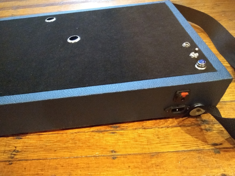

I didn't take any pictures of actually gluing the at-this-point cut tolex to the rest of the frame, because I needed to glue it all down pretty quickly after spraying, but I think these pictures give a pretty good idea of how I cut everything to make it fit. What I ended up with was a fully covered frame with seams at the corners on the sides and top, as well as along the inside bottom edge. Some of it turned out a little sloppy. Most of it is fine. Where the wood peeks through a bit, I just painted it to the approximate colour of the tolex, and you can't really tell without very close inspection. I assume this will need to be redone properly at some point, but it should look fine for a good long while.

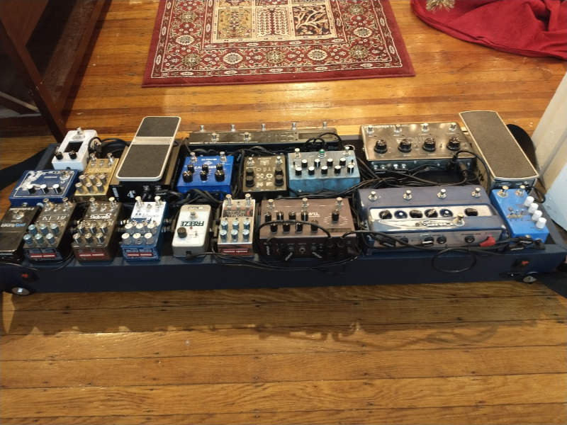

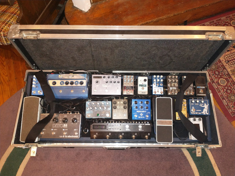

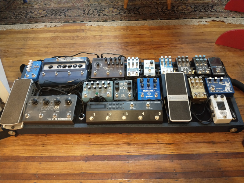

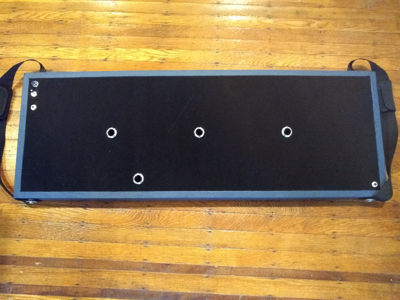

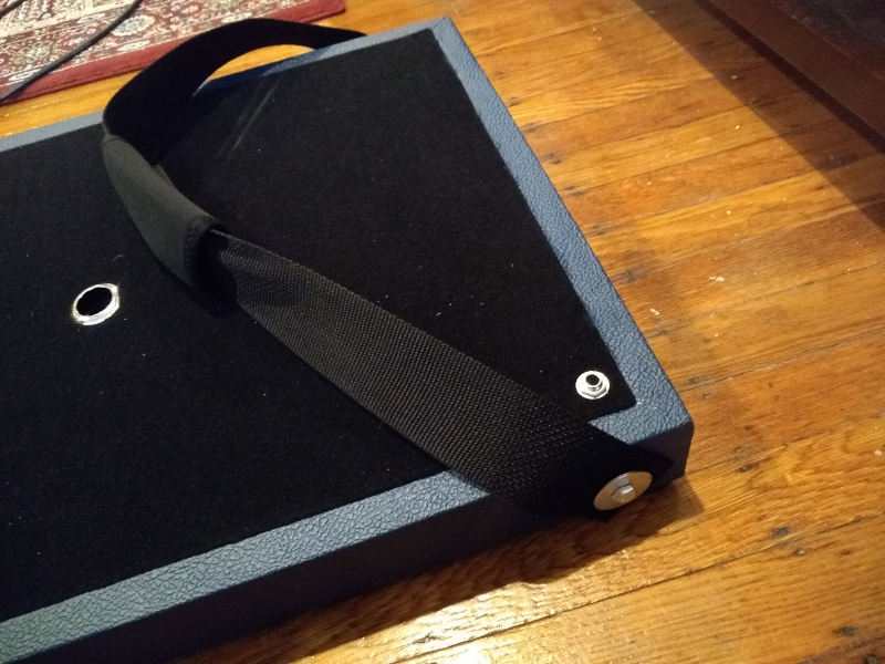

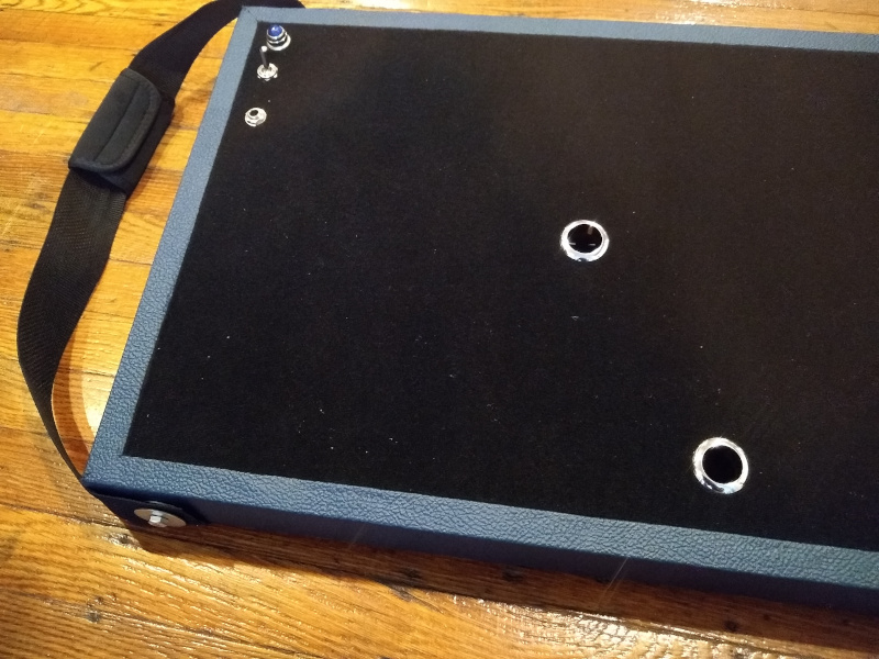

Re: Quarantine Pedalboard Project

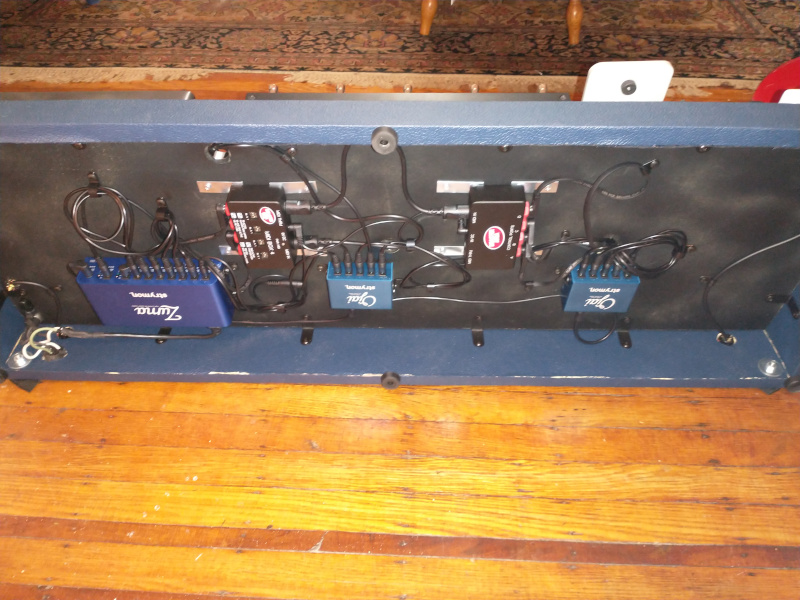

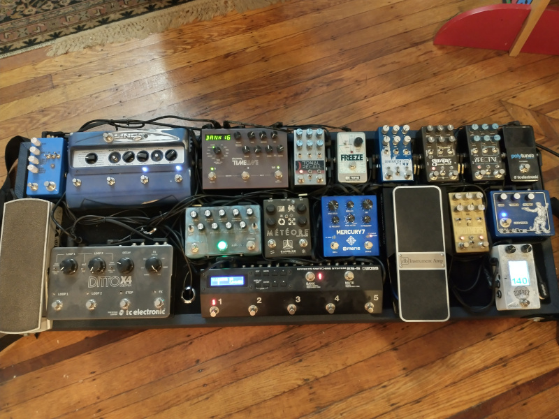

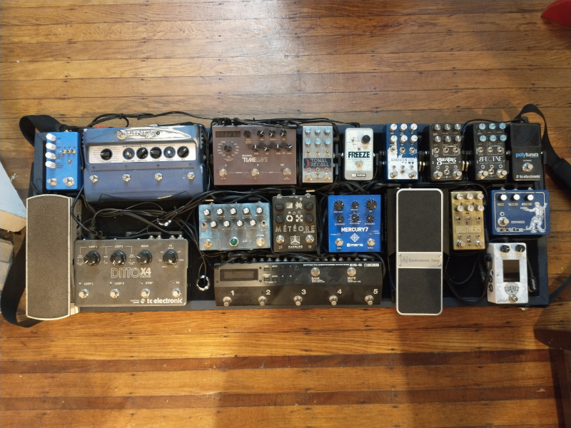

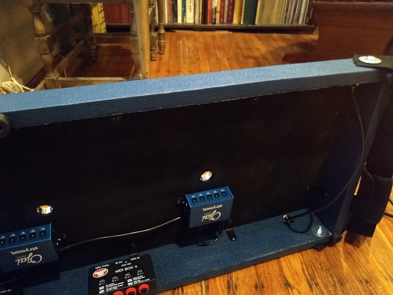

After fitting the carpeted top into the tolexed frame, I installed and wired up all the electronics, as well as installing some straps (without which I would literally never be able to get the board out of its case). I used some pre-grometed tree landscaping straps with luggage handles added to them, and just bolted them on somewhat loosely, with liberal washer usage, so that they can be stored on top of the board when it's in its case (for ease of removal), but tucked under the board during usage. I apparently again neglected to document the pre-drilling of the holes for these straps, but I obviously did all that before adding the tolex. At this point the board was done, so the rest of these pictures are basically just porn.

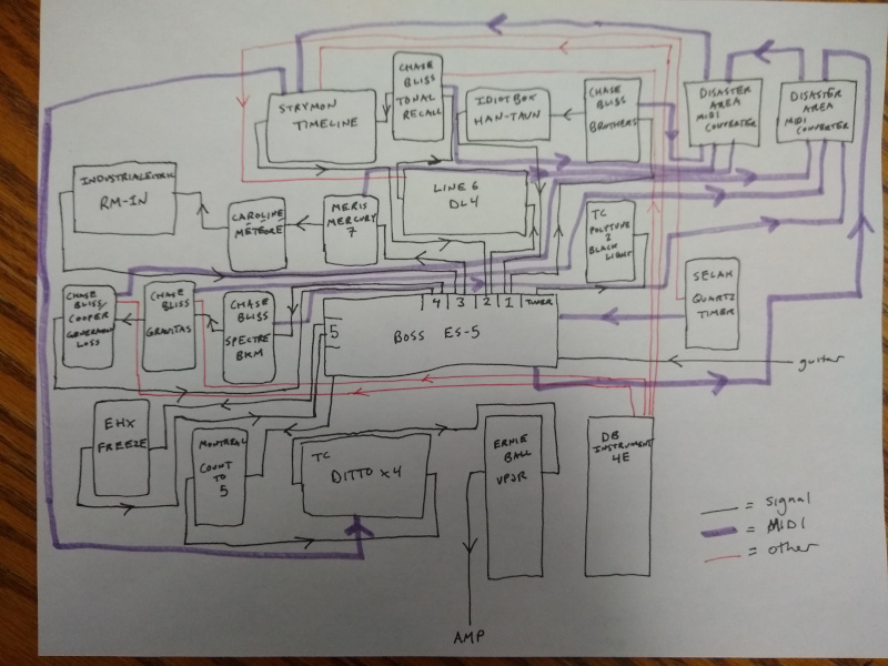

For those who might be interested, here's the signal path sketch you can see smaller in one of the above pictures. It's a bit much, but, you know, it's a lot of pedals and it was a lot of MIDI capability and expression control to otherwise be leaving on the table.
