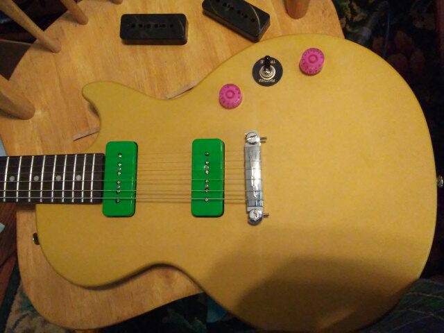

kosta wrote:Do you have a pic of said guitar?
I have a pic of the one i own in Worn TV Yellow. I'm not gonna strip it, but am planning on getting a Worn Cherry to keep as-is, & will possibly get another TV Yellow to strip & stain.
Here's a pic of mine (I put on green P90 covers & pink speed knobs. Worth mentioning that in person, you can see some of the grain, but not so much in the pic)
