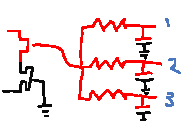

9 volt batteries are not built to provide a lot of current, so your intent may be a flawed concept right out of the gate.
That said, a small value resistor (I tend to grab 100 ohm) followed by a capacitor to ground helps decouple the circuits from one another. So, from the 9 volt battery, EACH circuit will be powered by a wire that has passed through a different resistor and has a cap across the power rail to ground.

Maybe this image helps?

Actually it does, but if I may how are you splitting the wire into 3 sections? just solder or are you attaching it to something that splits it off?

When I stuff a multiple I usually find a point that I can simply attach a bunch of wires or parts to and solder everything to that.

Yeah I'd use 5 rows and have the 9v battery ground go to one row, the 9v + go to one, then run a 100r resistor from the + rail to each of the 3 remaining rows.. then an electrolytic cap positive leg on each of those 3 rows with the negative leg going to ground.
So then you have 3 decoupled rails with a 100r load resistor off one 9v.. any of the remaining holes from the power rows can have the positive wires of your devices, and then the negative wires go to the ground row
Here's a slightly more complex thing that does what you're asking.

BetterOffShred wrote:Yeah I'd use 5 rows and have the 9v battery ground go to one row, the 9v + go to one, then run a 100r resistor from the + rail to each of the 3 remaining rows.. then an electrolytic cap positive leg on each of those 3 rows with the negative leg going to ground.

5 strips because you want a 9v in a 9v ground in, and then 3 decoupled 9v supplies. All the grounds would hook up to the 9v ground strip..
