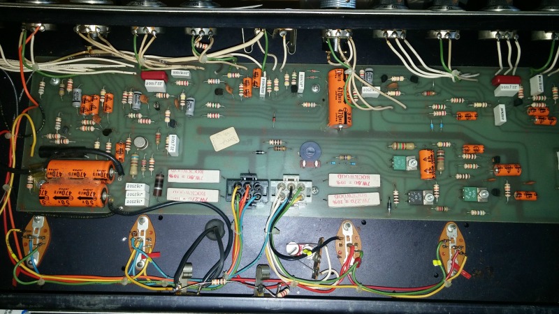

Upon inspection of the chassis I see a few obvious bulging/leaking electrolytic caps. I've compiled a list of all the electrolytics on the board. Should I go ahead and replace them all or just the obviously bad ones? They're more or less all the same Japanese made "SS" caps so I would assume they're all about at the end of their lives.

These guys are power supply filter capacitors? These are also electrolytic? Upon desoldering the leads and hooking up the DMM set to read capcitance, I receive a reading of OL on both of them after about 10-15 seconds no matter the orientation of my pos. and neg. leads. With minimal apparent PSU noise I will assume these are working properly and that I must just be testing them wrong.
