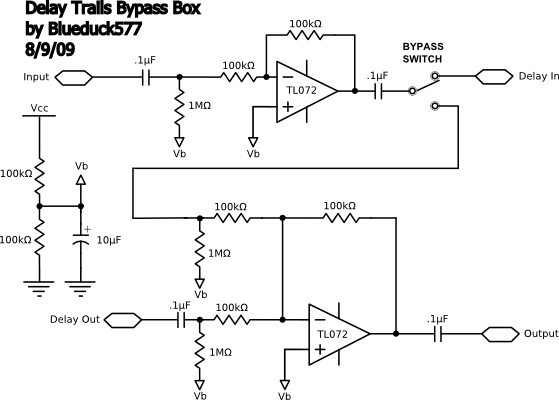

So, I want to get a cheapo analogue delay as a stop gap until I get something better, in the distant future, and a lot of the options don't do trails, so I was thinking...
How hard is it to build a parallel type loop that cuts the signal to the loop, but allows the delay/whatever else is in the loop to trail on? (I thought it'd be cool to have it run patches of stuffs, as you would.)
If this is a thread already, point me in the right direction, and apologies.
Also, I can't find a schematic as every thread I dig up about this on the internet seems to confuse people and they just go, "buy a delay with trails". Not helpful.
Also would be cool to stick it in the one box with my true bypass loop.
Any thoughts, oh genius council of ILF?

How about an A/B pedal, with a y-cable out of the delay. Send A to one side of the y-cable, and send B to the delay and then to the other side of the y. Send the joined leg of the y-cable to your amp or whatever's next.

I know you get it, John, but maybe I wasn't clear enough.
Parallel loops allow the signal to be cut to the pedal, but allow the wet signal from the pedal to trail out, in the case of a delay.
I'm sure Ax knows that, I probably just worded it like shit.
Still toying with the idea of building one, I think a volume/mix control would probably be necessary.

Iommic Pope wrote: Still toying with the idea of building one, I think a volume/mix control would probably be necessary.
And a couple of buffers. Passively mixing those two signals will most likely not work without significant volume loss.

I had this idea a long time ago and Mcspunkle actually invested the time to build it and sell a few. this has been done before. you guys are on the right idea with buffers and unity gain mixers.
http://www.ilovefuzz.com/viewtopic.php?f=151&t=9571

Found these:
Didn't realise that would be transparent. Strange)
(original thread:http://www.harmonycentral.com/t5/Effect ... 679/page/2
and additional notes by the dude: http://www.diystompboxes.com/smfforum/i ... ic=91566.0
clip: [youtube]http://www.youtube.com/watch?v=QhQF6xgX ... 7Iz1v1Sx0w[/youtube])
And this one: Image
(original thread: http://www.tdpri.com/forum/vbseo.php?vb ... ender.html)
Obviously I don't need two loops. Just joining a TB loop to the second trails loop.
